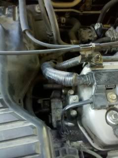

So apparently I don't have an EGR. This car is different than those i'm used to working on. I can't believe there is no mass air flow sensor either. I guess the less components the better for fixing, ha ha. I measured the fuel pressure with the inline gauge i rented at autozone. I took off the hose from the firewall to the rail and used 5/16 tubing, it was a little too big but i use clamps and it was not leaking. It read exactly 44 psi throughout the rpm range, idle to wot. I know its not the regulator, pump or fuel filter. Here's a pic of the area that the EGR should be located.
I will take a look at my valves tomorrow, i just have to get a new gasket first and it's hot as hell in Houston right now. Thanks for the replies guys, this is really annoying me. What are the chances a clogged cat is causing this? It has run to the higher rpms when it would start so i kind of ruled that out.

I'm still hunting down this problem, i was able to borrow a scanner and read some of the sensors. Everything looked ok, the o2 was switching fine and everything was in range. The one thing that stood out to me was the MAP sensor. It was reading around 65 kpa at idle. In the service manual it says it should be below 40 kpa at idle within 1 second. Could a mechanical issue cause a low vacuum scenario at idle? Another thing that bugged me was the voltage of the map when the car is off. It was sitting at 2.7 volts. Shouldn't it be close to 5 volts with no vacuum? I just want to make sure i don't waste money on a new MAP and it turn out to be a slipped timing belt or something major.
Old Aug 14, 2011
lazlong's Avatar
Joined: May 2010
Posts: 3,662
From: Funkytown, Tx
Rep Power: 236
Re: Code p0172 and Hesitation Problem
low vacuum= vacuum leak (probably a hose)
It should sit at 2.9V with the car off and the ignition ON(II).
It sounds like your getting an intermittent fault because everything in the engine bay heats up and expands pulling the connection(s) apart. Check the connector at the MAP sensor very closely.
