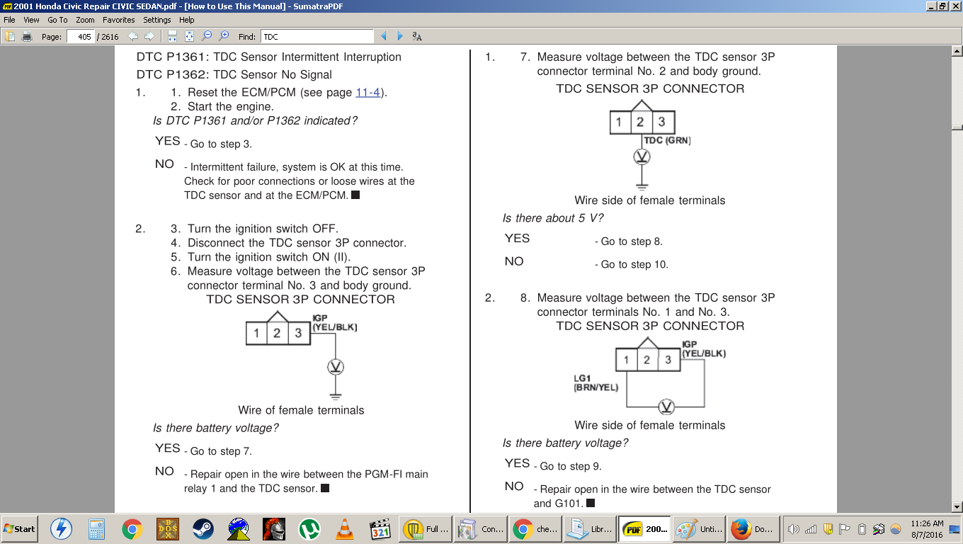

From the 7th gen Civic service manual. I am having the P1361 issue and am bringing it in tomorrow to get it diagnosed. I hope the mechanic has a passion for this issue like I do being I sought out this technical info from the service manual.
Name:	P1361 Serv Manual.png
