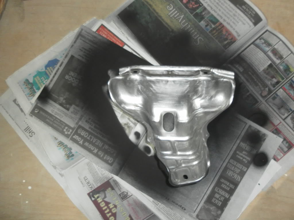

Went out the other day to diagnose a loud metal on metal noise under the hood and I noticed that my exhaust manifold heat shield rotted out by the bottom bolt. So, the bolt wasnt holding it on and it actually started to crack at the top and the vibration started to rub a hole in my exhaust manifold (caught it early enough no damage done). Just a thought for those of you who live in a cold climate with lots of salt on the roads to go out and check it. If I had left it on it would have broken off at the top bolts from vibration and possibly ended up smashing into the radiator fans which would have been a costly repair. Heres a pic!:

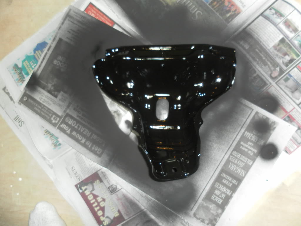

Here is tonights project. I really don't want this thing to rust out again so I've decided to ceramic coat it with manifold coating... Fireproof!!!:

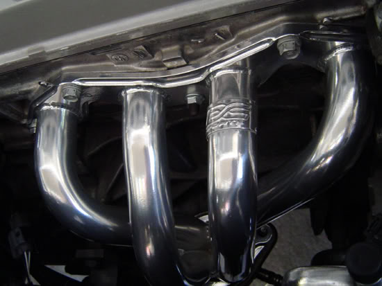

lol nice. couple pics of my new one. this is after a few days of driving so hopefully it doesnt fade too badly

Nice Steve. Definitely looks better but I don't wanna spend the cash. How much was the header? I like how it bolts on instead of the nut-stud type which is a royal pain in the *** when it comes time to remove it. But I guess you can do that with an OEM one too.

I spent a good half hour scuffing it up with some fine grit automotive sandpaper. Now I have the third coat drying, I gotta say I really like the flat black. I might paint a bunch more stuff under the hood with it:

Quote: I spent a good half hour scuffing it up with some fine grit automotive sandpaper. Now I have the third coat drying, I gotta say I really like the flat black. I might paint a bunch more stuff under the hood with it:
That looks great!
Honda should have made them that way to begin with.

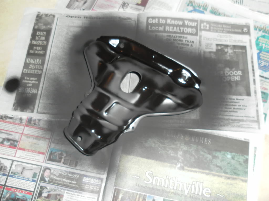

SOOO Appareantly I'm SUPER camera happy tonight.. and bored as hell... so here are a few more of one side finished :

LOL I need to get a life... seriously
