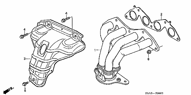

Crack in a DC header, wow. I would certainly try to get DC to replace it. How old is the header? Anyways, about both of the links you attached... the connection where the pipes all come together forming the actual "4-1" looks like its at an angle and Im not sure if the OEM part is, it may very well be but I don't remember without looking. Looking at this attached diagram of the original part then comparing it to the links, the lower connection to the rest of the exhaust pipe does look angled, so i have to believe those links you attached are for a different type of aftermarket exhaust systems. And if we could back up, did you have a OEM manifold when you bought the car or it came to you like that? If I were to purchase the OEM manifold ($125) I would buy it off of http://www.hondaautomotiveparts.com . Oh and I wouldn't bother welding it unless you know someone who would do it for cheap like less than 100 bucks. Take a picture or two I'm curious to see how it cracked.
$250 for a bearing isn't too bad, its an easy job if you have the right tools but in your case where you don't have a hydraulic press (not to lift the car, thats a jack, but to press in parts, pins. etc. ) it would cost you more to get all the tools than you would really save on doing it yourself. So if I were you pay Honda to do it.

Oh and I just re-read your very first post, I forgot you already told me you had a DC header, whoops. Anyways, that very first ebay link does looks like it would work for you if you don't want OEM.

OEM is $75 here: http://www.bkhondaparts.com/billkay/...itch=&hidIrno= or here: http://www.hondapartscheap.com/south...t=0&quantity=0 Shipping for both places is about $20.

Greatly appreciated friend! Am I correct that I would just need the Illustration #1 and #2 parts? Do I need the cover? Is it a good idea? Doing the installation myself also seems fairly easy, or is it difficult?

There you go man even cheaper. Heres a post I responded to not too long ago about doing the same job. You don't need the cover btw. https://www.civicforums.com/forums/3...ease-help.html

...Am I correct that I would just need the Illustration #1 and #2 parts? Do I need the cover? Is it a good idea? Doing the installation myself also seems fairly easy, or is it difficult?...
Heatshield isn't exactly necessary but, it's cheap insurance to keep all the stuff around the exhaust manifold from melting or catching fire. I would get it. If your doing the install yourself you also need #15 and 16 (2 of each): http://www.bkhondaparts.com/billkay/...itch=&hidIrno= Those bolts are a b**ch. Hit them with penetrating oil first then if they don't come off just cut them off.

Read the post and it seems pretty straightforward. Basically the bolts are gonna suck. But I'll see, might just have the place do some labor if my uncle and I aren't up to the job. Either way, thanks for the help!
Lazlong,
Awesome links!!
So I buy part #1 and #2 in the original links and then 2 each of part #15 and #16 in the second link? (Also, the link was for a muffler, but I'm assuming it's just the same nuts and bolts that can be used for the header right?)
You both have been a great help!

...So I buy part #1 and #2 in the original links and then 2 each of part #15 and #16 in the second link? (Also, the link was for a muffler, but I'm assuming it's just the same nuts and bolts that can be used for the header right?)...
Correct. (Your looking at the muffler on the right. Look at the front of the exhaust on the left and you'll see #15 & 16 too. That's why it calls for 4 total each, you only need 2 each.) Good luck, keep us posted.
