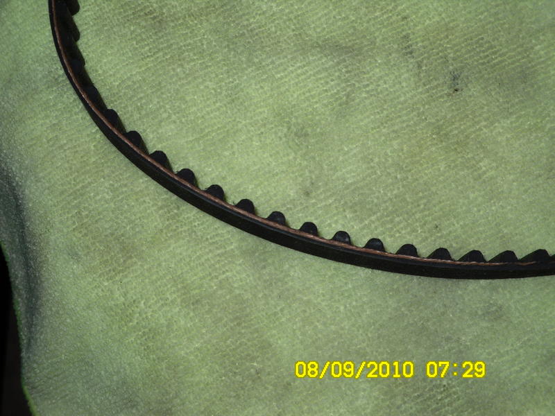

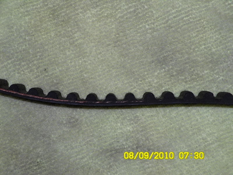

I just received my timing belt kit from Amazon and something doesn't look right to me.
What do you guys think? Shouldn't the sides be coated in that black thingamajig like the rest?

I am far from an expert, but I would be worried about that.
That string could potentially come de-laminated from the belt and make all sorts of hell. I would return the amazon kit and buy from Majestic Honda.
OR, you could go to napa and just buy a new belt, they are about $17, but then I would be worrying about the quality of the other parts in the kit.

The timing belt is the exact same brand as the OEM, and the same part number I believe. It was just sold by a different smaller company who had a rating of 100%.
I just got an email (two to be exact) from the company and they just checked their stock of timing belts and she said they're all like that. She thought my email was suggesting a defect on all her timing belts so she went out to their location and checked the timing belts. Now, that's customer service.
So, I'm good to go. Thanks guys!
