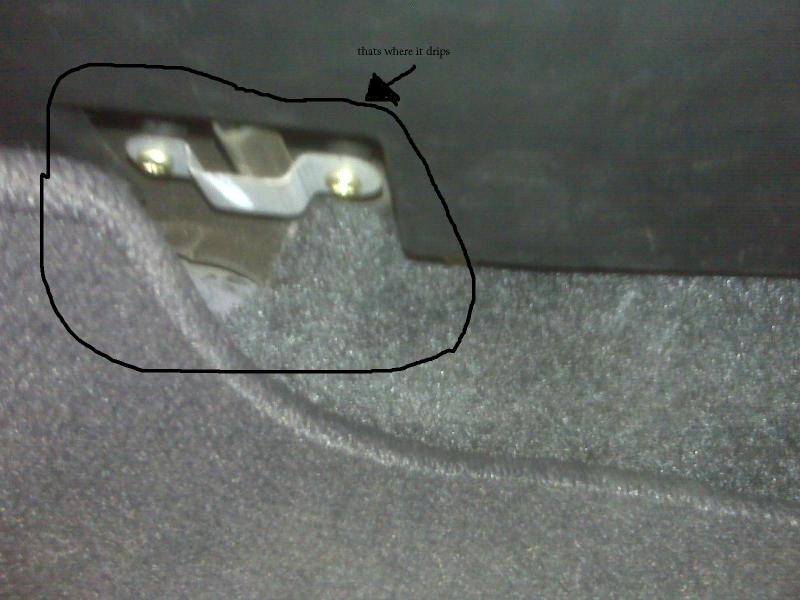

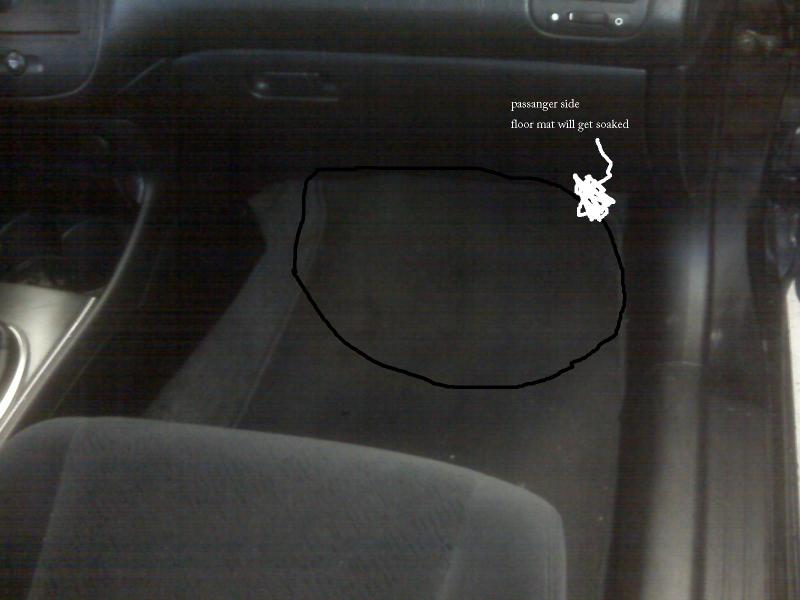

so on the passanger side it leaks water inside my car with the ac and the heater on and when i turn it makes a weird noise .. i check the search n didnt find anything help !

i bet its the a/c water drain thats supposed to vent water out the car. do you see water pool up under the car when you park and shut the car off? if not its going inside the car which isnt good.

Sounds like clogged drain hose.
A temp fix and test would be to run the HVAC system without using the compressor (either set to release green A/C light during defrost or use floor setting to keep compressor from running)
The hose exits underneath the car near the firewall.
You may need to locate the sloshing water and try to get it dryed up, It may or may not continue to drain onto floor.
