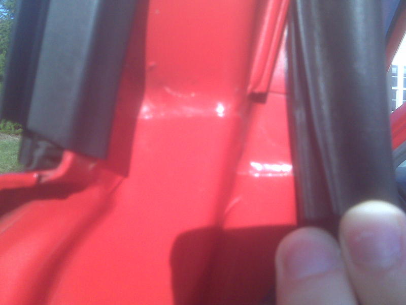

AAA came and used the tool to unlock my car, and now the top of the door is slightly sticking out. when i am driving and i hit a bump i can sear the door make a "smush" noise as the door shifts inwards and the seal smushes against the vehicle door frame. i can hear outside noises much more easily, and like i said the top portion of the door is slightly sticking out. however, thankfully it's NOT leaking water...just lots of sound and wind noise.
whenever i drive over 50mph you can hear wind noises and there is a slight pressure as a result of there not being a proper seal. from this pressure, my left ear begins to ache and it becomes quite an annoyance and i find myself having to pop my ear every so often on long drives. i really need to find a fix for this, but i don't have a good feeling about it b/c i saw that the weld that connects the top and bottom portions of the door is cracked and slightly shifted which could explain why it's sticking out slightly now. or maybe the top black plastic portion is warped from AAA's tool? how the heck can a weld crack though??? seems like Honda cut more corners on this Civic with these door welds.
it's extremely bothersome, and i will post pictures tomorrow of what i am talking about above

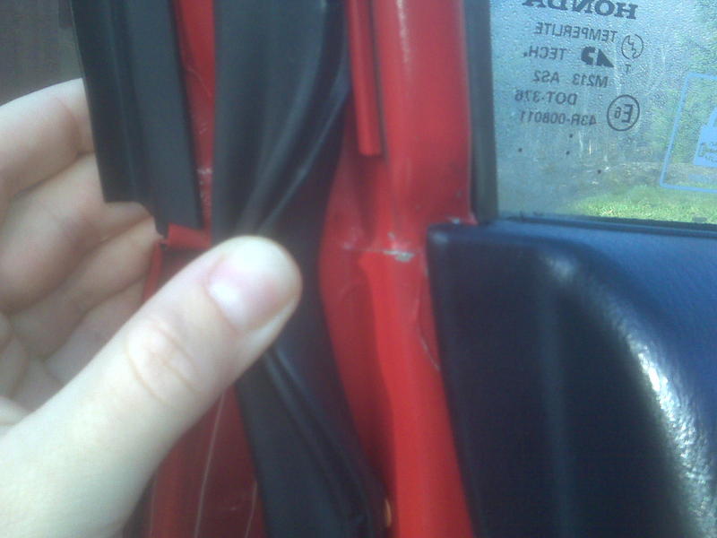

even if i extend the rubber stoppers, that won't get the top portion of the door closer to the body since the weld cracked and the top portion of the door is bent as a result. the bottom portion of the door is aligned perfect, it's the top portion that is "off". after carefully examining the door, that is my conclusion. however, after work today i will look closer at the tip of the door at the very top and see if the blast plastic strip can be bent at all. since this black plastic strip is externally attached to the vertical metal portion of the door, i doubt the plastic is the problem. i think the vertical metal portion of the door, due to the crack in the weld, is not aligned properly. i closely examined the weld in that location and i must say it is one of the most wimpy and poorly executed welds i have ever seen in all of my years of engineering. if Honda really Value-Engineered this vehicle this much to the point that they saved money by putting in shotty welds, i have officially lost all confidence in the company and will never buy one of their vehicles again. i know that is a blanket statement, but i just took a quick visit to CarComplaints.com and i noticed that their flagship Accord has been plagued with hundreds and hundreds of brake complaints for their newest gen Accords. heck, at this point i could have done a better weld job. i am uploading pictures in a few mins...

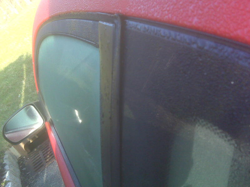

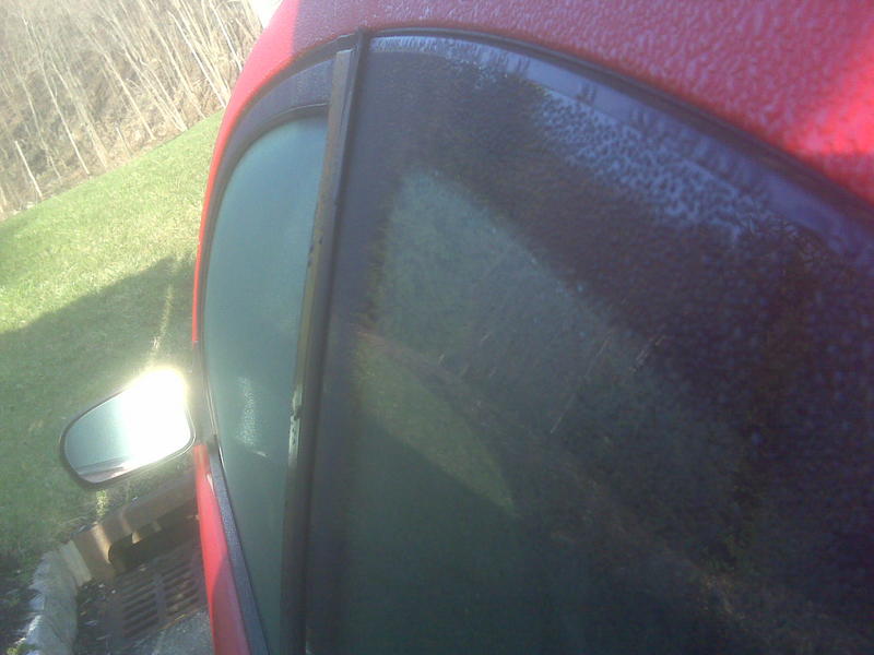

Pictures of driver's door gap with cracks in weld
here are the pictures of my door problem.
#1 : door gap
#2 : door gap zoomed in
#3 : apparent crack in weld
#4 : side-shot of weld, with the right portion of weld cracked
