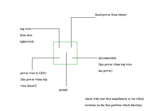

If you didn't want to go all the way into the roof you can reverse the positive timing using a series of relays, let me see if I can find that diagram. . .
Edit: O, I know an easy way with only 1 relay. Using a 5 prong relay with 1 ground, 1 power input, 1 trip input, and 2 power outputs. Several relays are like this through out cars. Power flows through one power output prong while the trip wire has power. Then when the trip wire doesn't have power it flows power through the other power output prong. So you would need to hook up the LED's to the prong that has power when the trip wire doesn't and leave the other power wire disconnected.
I can try to draw a graph.

I mean prongs on the RELAY, not fuse
