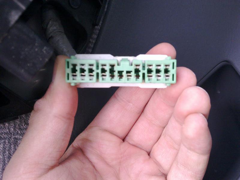

I dont understand which pins do I need to short for getting atleast the passenger window switch to work. If you can mark in the photo I have attached, it would be of great help.

Originally Posted by gearbox
did you try cleaning out the black stuff with alcohol and a qtip? worked for me several times before i finally bought a new switch.
The black switch for the passenger window on the master switch board is pretty much toast and the printed circuit under it is also burnt. I have a new switch on order, but would like to raise the passenger window while waiting for delivery. Seems like one should be able to operate the window by jumpering the right pins in the master switch plug since that is essentially what the switch does. Just need to know which ones to jumper to make the window go up. Alternative would be to remove the passenger side door panel and hook 12v directly to the lift motor (more effort than just jumpering the master switch).
