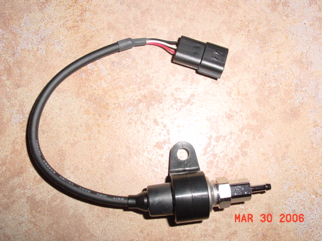

pressure sensor... what does that look like...lol I havnt called yet but if the wideband dosnt work then im deffently going to one of those places that you mentioned.
Does it look like this....if so I got one of these on. http://rds.yahoo.com/_ylt=A9gnMiT6GG...ure_sensor.jpg

that looks like it but it also look as though it may not be complete look at this pic
now when you referr to the wideband it sounds as though you think if you hook it up it will cure your problems. that is not the case the wideband will tell you your air/fuel ratio and nothing more. you have to physically tune the air/fuel ratio from the emanage yourself to fix the problem. the sensor itself is just a monitoring tool. i know you want to cut costs and you really want to conquer this yourself but is it worth the motor?? you may have a lot more down time and end up costing yourself more money than a tune would cost if soemthing gives. i hope not for your sake. but ill offer all the help i can!!

just did soem research myslef and it looks as though that is the correct sensor now the question is does the emanage recognize and what are the settings at
