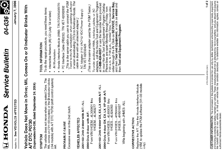

there's another honda auto tranny TSB out...
came out on Jan5/05
TSB 04-036

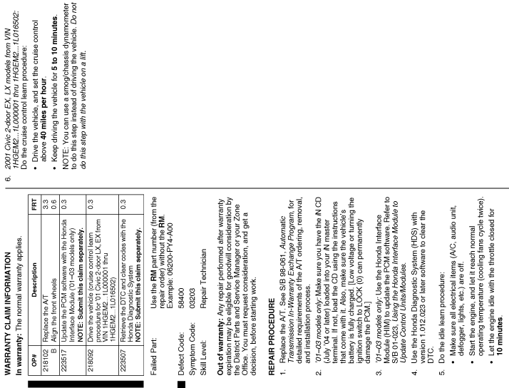

yes i do but it's a gif...
it's also not one of the useful TSB's...
basically tells you that if your car wont move, the tranny is f'ucked..heh...

here it is...

So, it's just telling the techs to replace the tranny?
