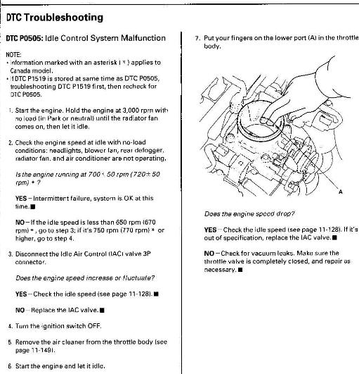

My car is throwing off CEL P0505 x 2. It is idleing like crap. When it is warm/at traffic light, car idle at 1200-1300 . When I let off the gas padel, the rpm will jump back and forth (within 150-200rpm).
Will be taking off the intercooler piping off the TB tommorw to clean it. Anybody has any idea how to fix it?

here is what i found in my handy book
