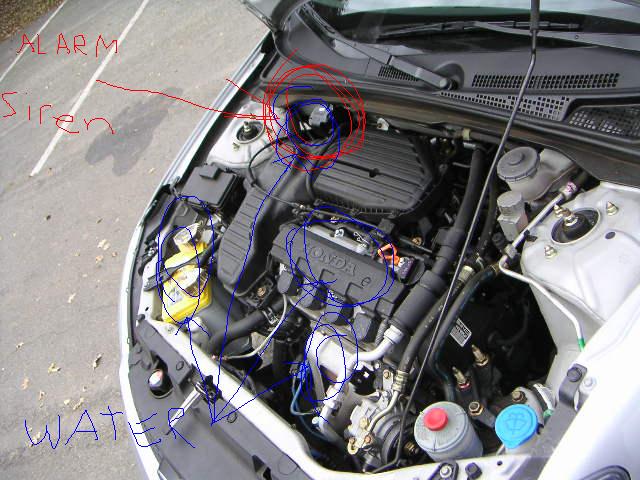

ps. here is a pic i drew for ya

No, the siren will dry out. But if it gets soaked a few times, It WILL die. I suggest you put a thin plastic cling wrap over the horn when it's raining outside. Another fix is to mount the horn at an angle, so the water will just drain out of the center part of the horn.

Who did your alarm install? It is a given assumption that every installer mounts the siren pointing DOWN so water doesnt get into it. To me, that's a DUH thing.. dumb @$$ installers I tell ya.
