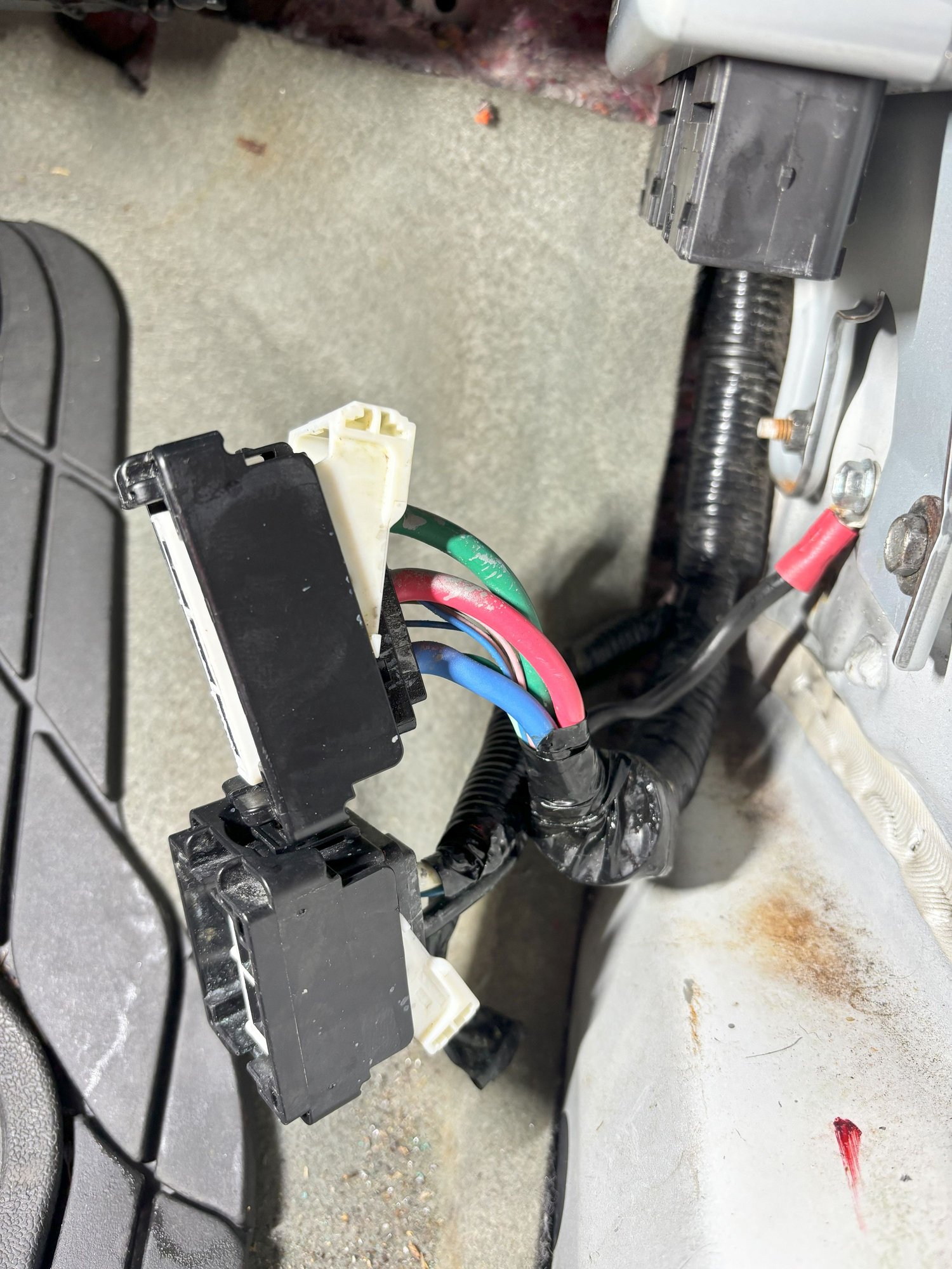

I need to replace the two connectors on the wiring harness that connects to the EPS control unit on my 2012 Honda Civic LX. Through much troubleshooting and diagnostics, the connection appears to be the source of my power steering woes. The connectors are corroded from water damage, After much cleaning and a dab of dielectric grease, I cannot seem to get a stable connection. I have a known good EPS control unit. For the life of me, I cannot seem to find or identify the part number for these connectors on many of Honda Parts websites. I even have a ticket in with Honda of America and they still haven't gotten back to me in over 10 days. Looking for EPS Control Unit Connectors A (11P) and B (16P).
2012 Civic EPS Connectors

Go cut one off a car in a junkyard. Leave enough wire to crimp or solder
