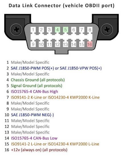

Is there any harm in shorting the ODB2 port pins 4 and 9 while the engine is running?

Just buy a scanner
