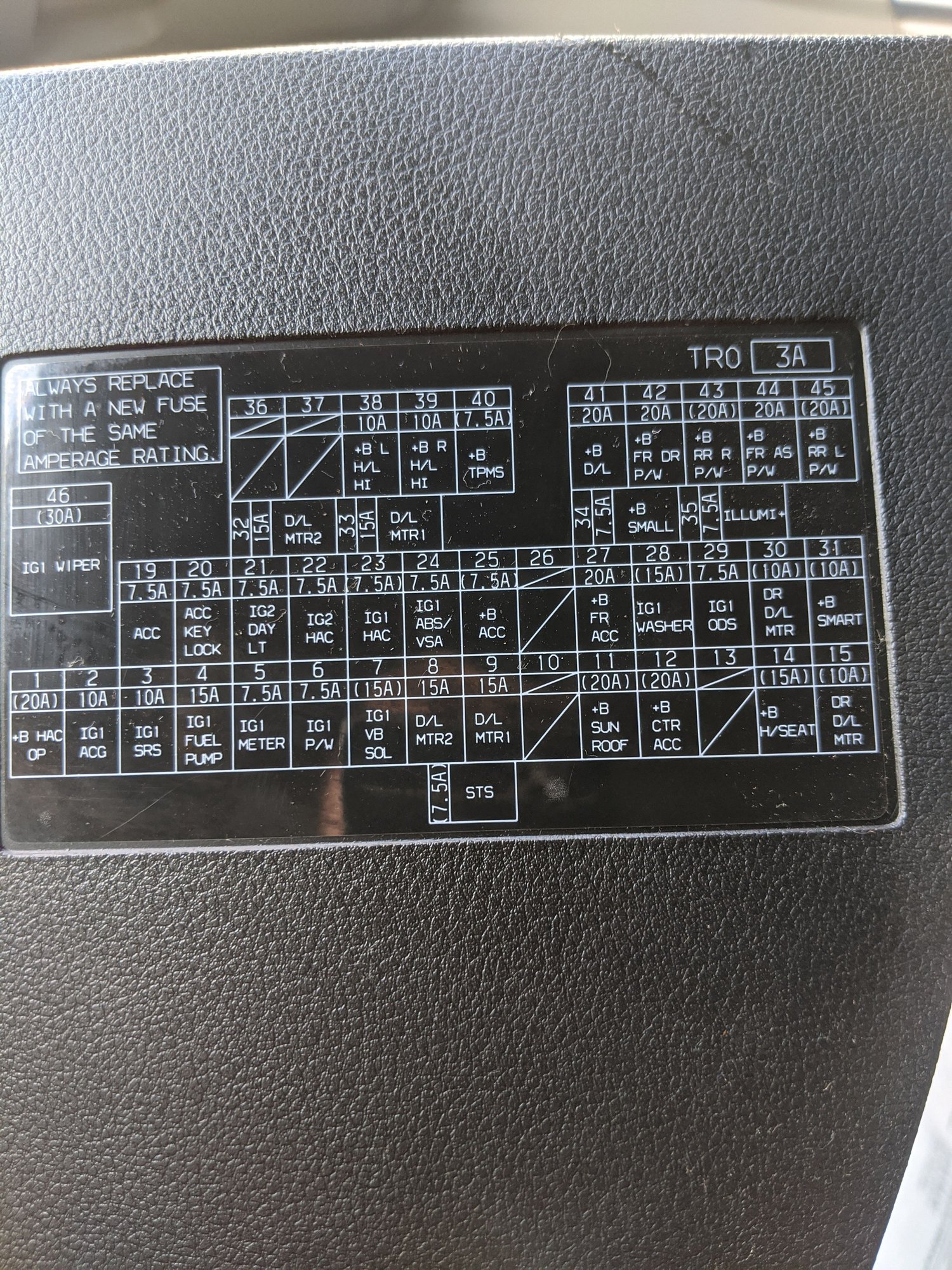

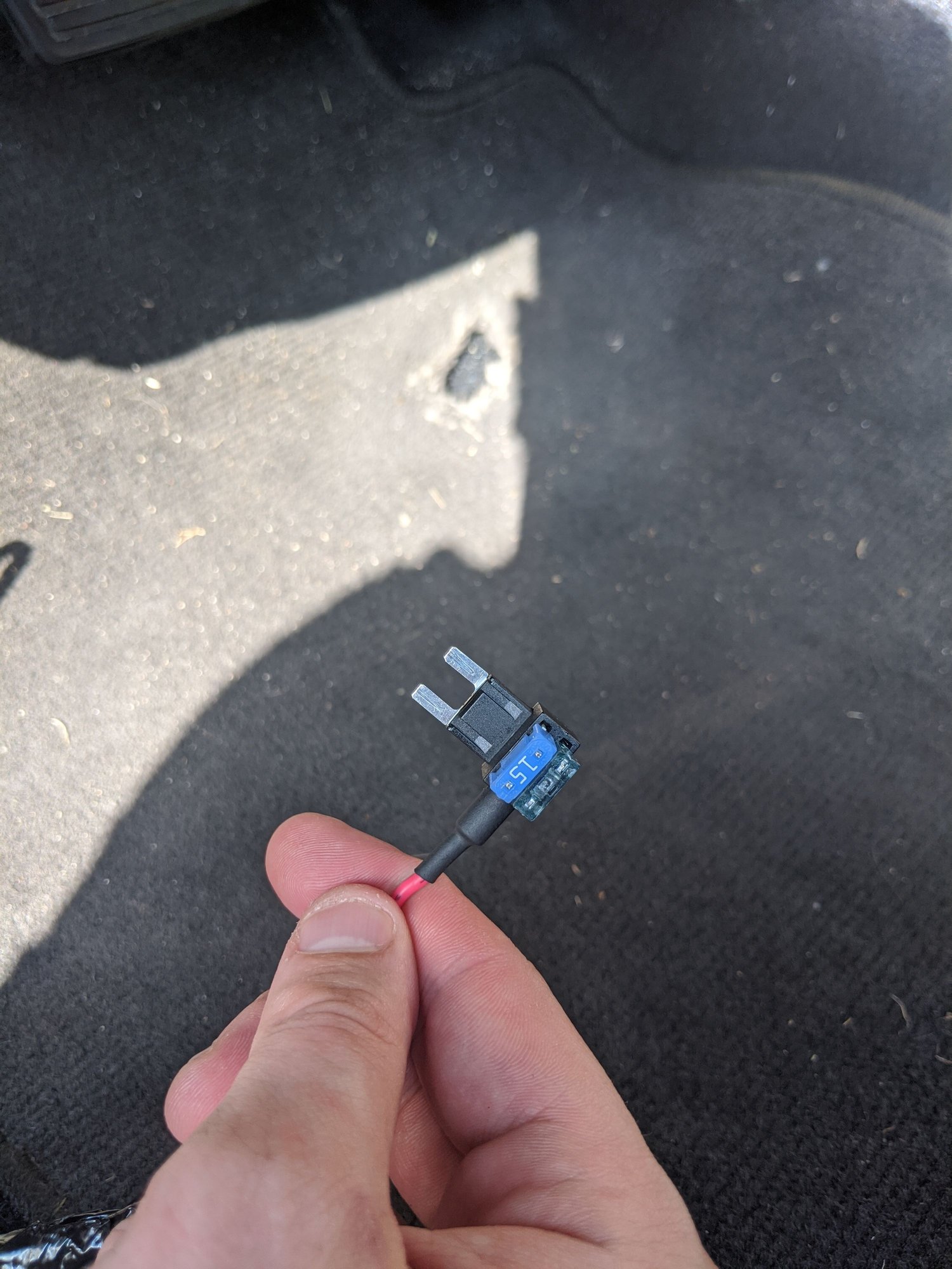

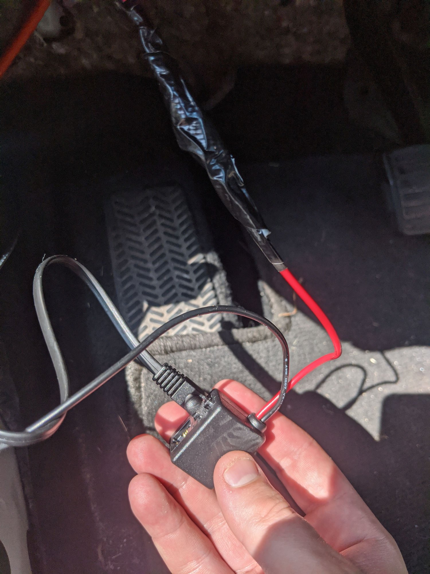

I'm installing my Valentine radar detector and I am tapping into the fuse box to power it. I am using fuse box #27, which is also the cigarette lighter. I bought the adapter to run the inline fuses, so I plug in the 2 fuses to the inline fuse, then plug that into the fuse box, #27. I ran the ground wire behind the bolt that holds the hood release.
Issue: the cigarette lighter works as expected, turns on with the car/accessories and off. The radar detector is always on. This doesn't make sense, since the cig lighter works as expected.
Can someone make sense of this behavior?
