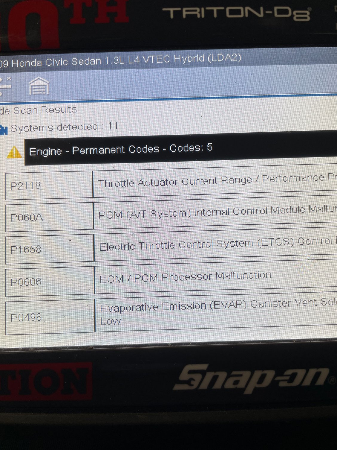

Got a code reader and see the following 4 OBD's :
P1659 : google says one of these issues - ETCS Relay
- ETCS harness is open or shorted
- ETCS circuit poor electrical connection
- Faulty Engine Control Module (ECM)
P060A :
P0606 : In all likelihood the PCM/ECM has failed
In all likelyhood the PCM / ECM has failed
Read more at: http://www.obd-codes.com/p0606
Copyright OBD-Codes.com
P0498 : Faulty vent valve or wire/circuit issue
this looks bad

The P060x codes pretty much confirmed the PCM. I was hoping for a simpler solution but not holding my breath.

I think you probably shorted out the VCC line to ground and wiped out the component that regulates that voltage supply. You should find the FTP sensor also lost its 5v reference voltage too, it shares that same VCC6 circuit.
Your P060x codes are internal failures in the PCM.
P060A troubleshooting is short and sweet: erase code, see if it returns. Try a known good PCM.
P0606 has a TSB about not using aftermarket spark plugs with a built in capacitor as they cause electrical interference. Otherwise, troubleshooting is about the same as above: Erase codes. If it resets the code try a known good PCM

I did the exact same thing but still have 5 volts on the red wire but still no start.
Old Apr 26, 2019
Re: Killed engine while testing A/C
Got fault codes?

Ezone I have a 2009 honda civic. Will crank but wont start. Throwing codes for ECM p1659a p0606 p0498. Any help? The ac wire has 5 volts to it

Did you read the thread? Perform the same troubleshooting.
