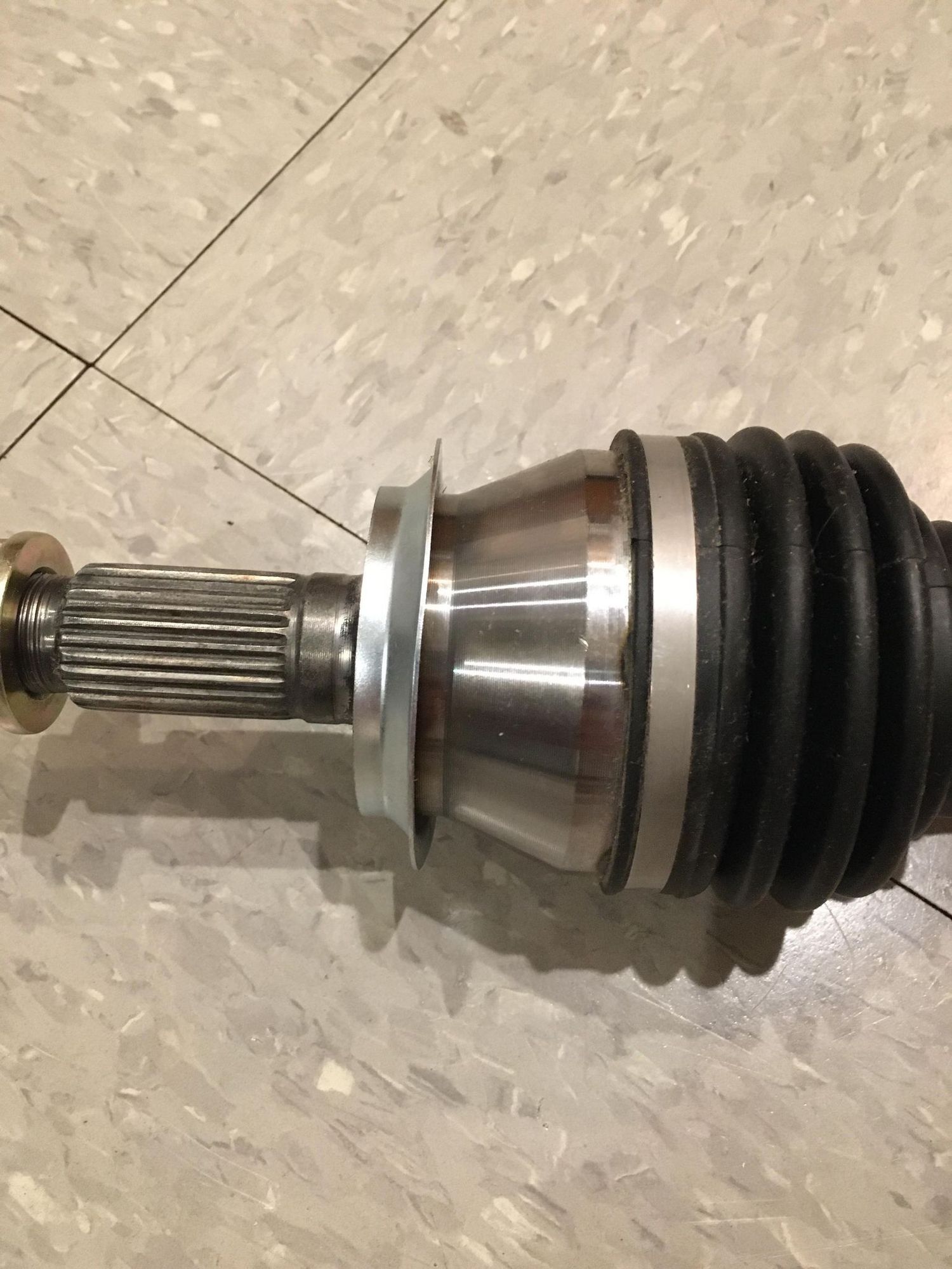

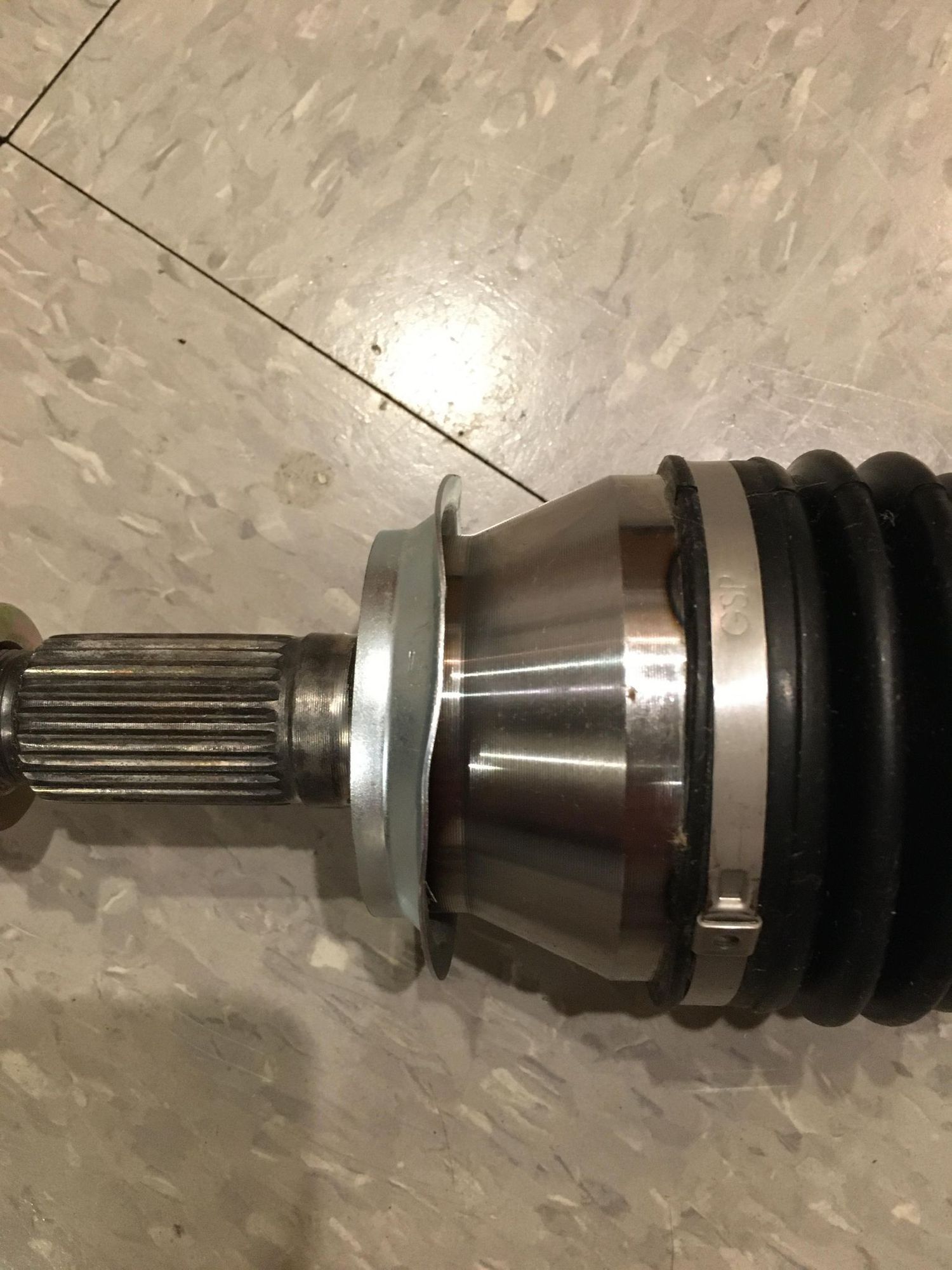

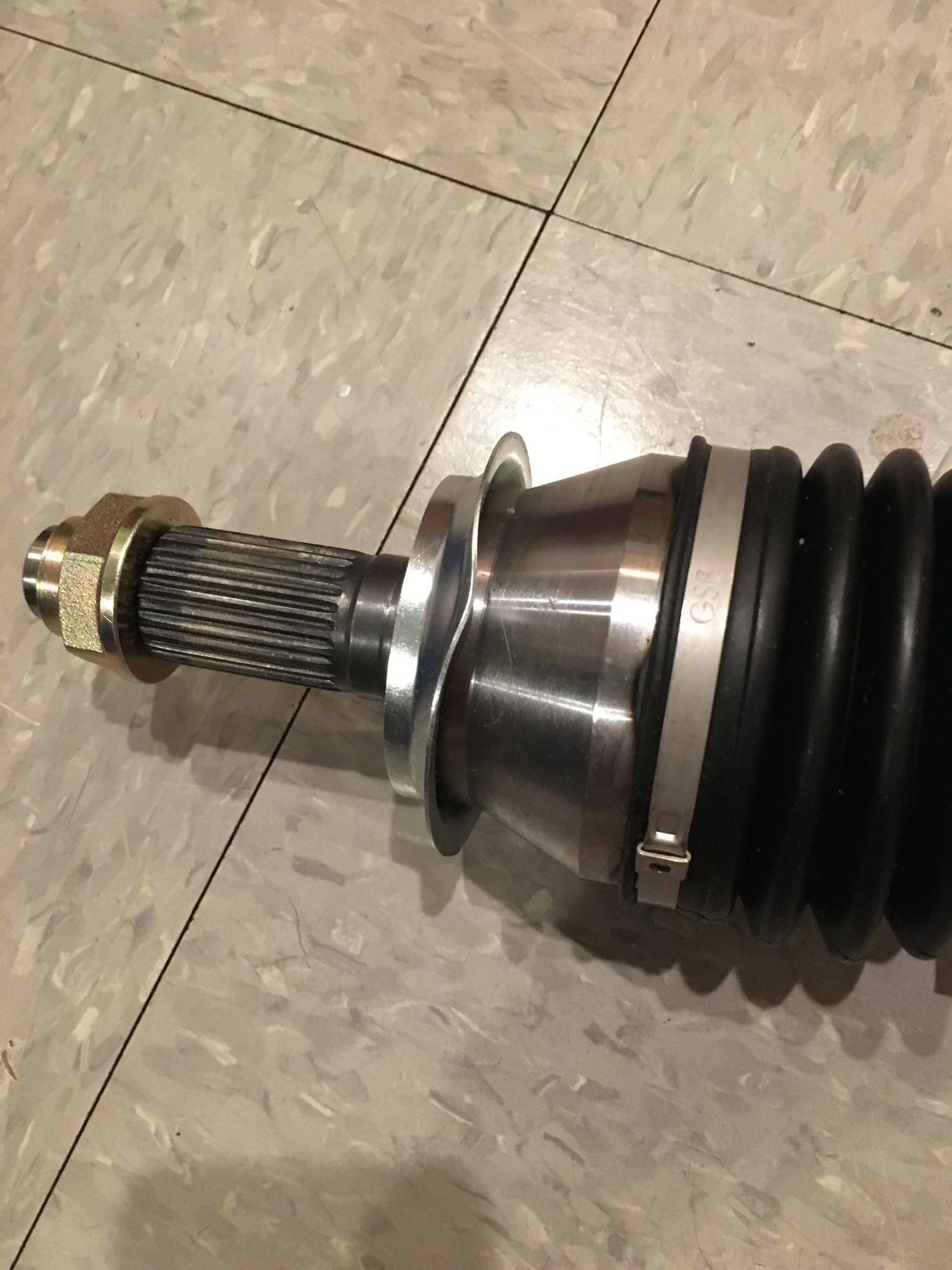

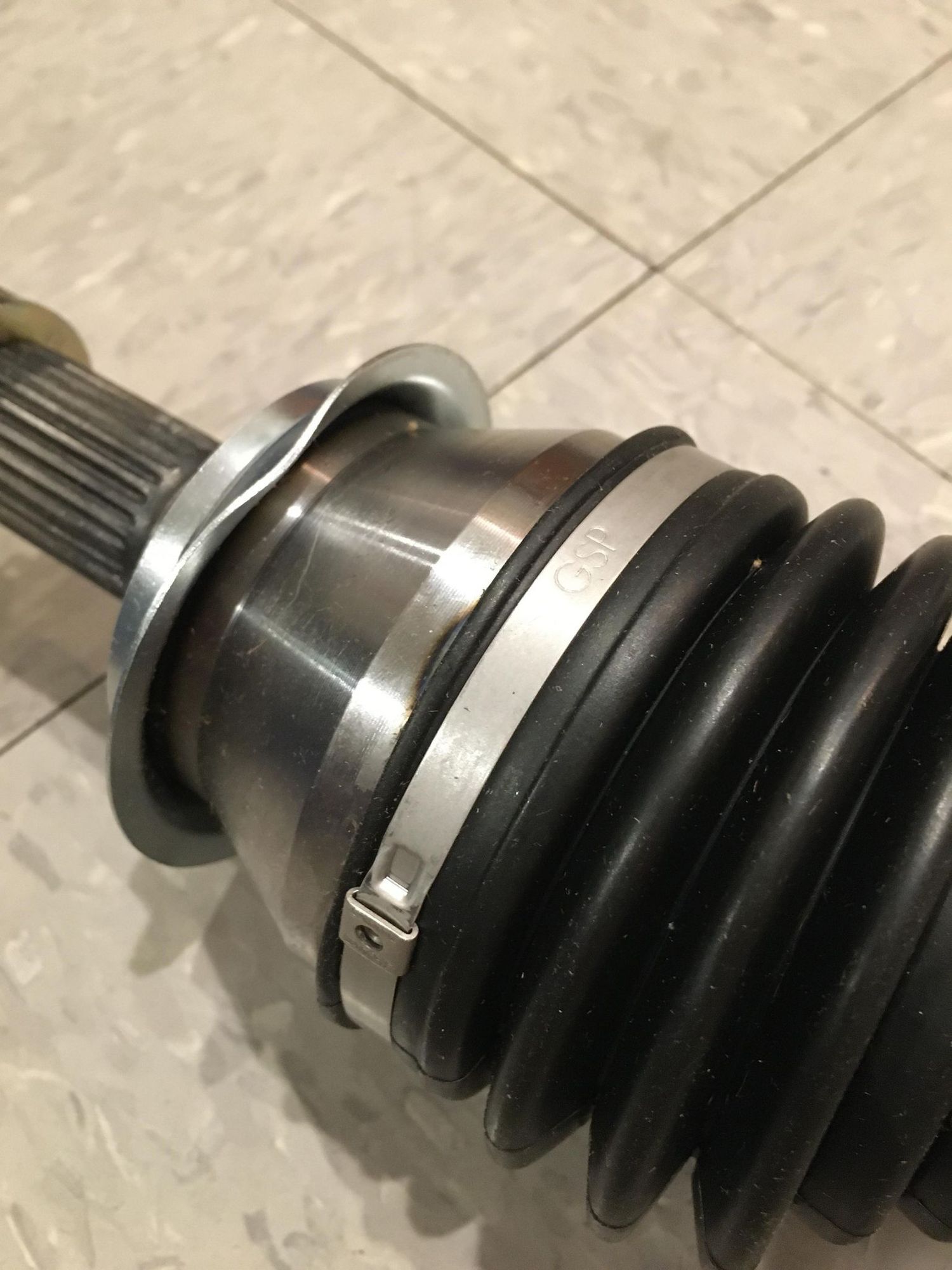

The two cv axles (passenger and driver's side) each have a metal ring at the hub end which I think is a deflector/dust cover/dust shield. Both of them are bent in one spot and one wasn't attached to the axle, so I lightly hammered it in place. Should I be worried about these being slightly bent? I'll include photos. Should I try to find new metal dust covers?

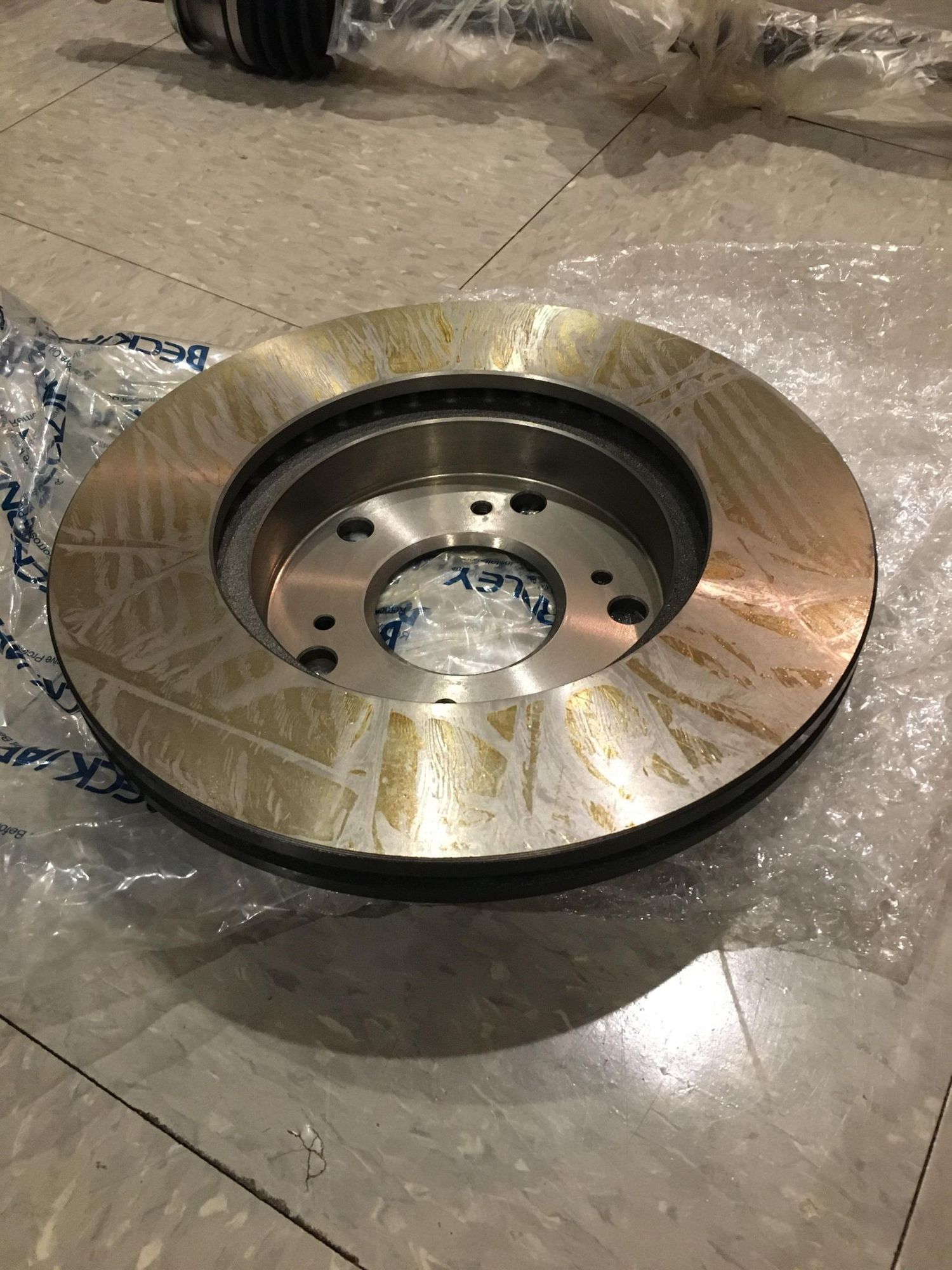

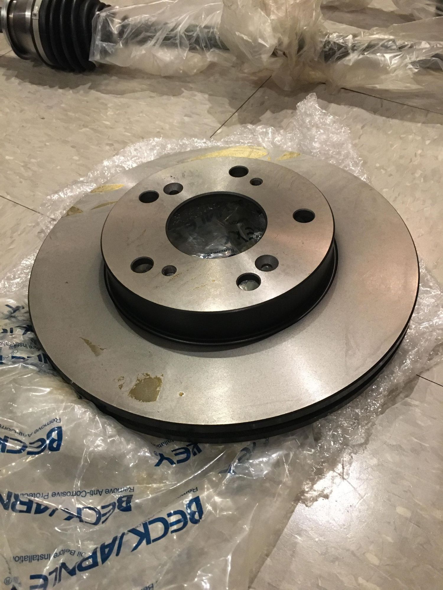

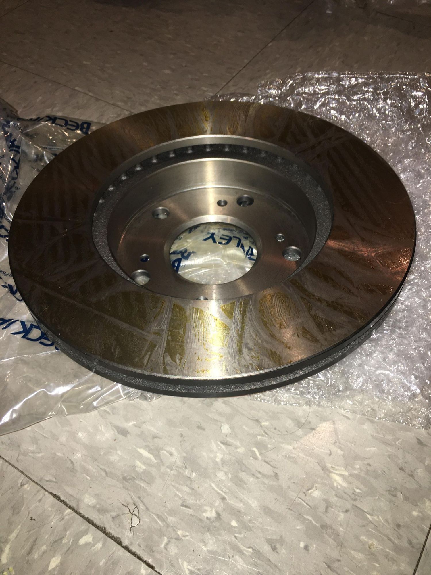

I purchased rotors (Beck/Arnley 083-2911) but I was wondering if I should paint the middle "hat" portion of the rotor for rust protection? I have high temp spray paint. I know to NOT paint the rotor surface where the pads rest. Should I paint both sides? The outer sides of the rotors and the sides of the hat portion are black, so they might already be rust protected. Note: I have black steel wheels with hubcaps, so painting them would only be for rust protection, not aesthetics.
I heard I should spray brakecleen on the new rotor surface to get off anything manufacturer put on them to prevent rusting. These look like they have stuff on them.

Looks like that that metal ring on the CV axle is just a temporary dust cover or it may be protecting the ABS ring. If it pulls off easiily it's probably just a cover.
When you pull the old CV axles out match them up with the new part and if the old one doesn't have that cover then it's most likely not meant to stay on during installation. Also, always matchup old and new parts for fitment purposes.
Some rotors have a rust protectorant coating on them. Call the manufacturer's tech support line prior to install to find out if that's the case with that particular model number of rotor you purchased.

Buy a good quality brass brush (home depot) and plenty of brake cleaner spray. Use both to clean rust, dirt, grease from the wheel hub mating surface the rotor will contact. You want the most even, smooth contact as possible there.

Thanks! Should I add anti seize to the hat of the rotor?

I've never used it there. If anti-sieze is not there when you remove the rotor then its probably best not to use it.

I checked my old cv axles and it looks like they didn't have the metal ring dust covers, so maybe I don't need them.

What brand calipers do you recommend? Also, should I remove those metal dust cover rings from my new cv axles? The original ones on my car now don't have them.

Never seen covers like that, ditch them.

yes. are they covering the abs ring?
