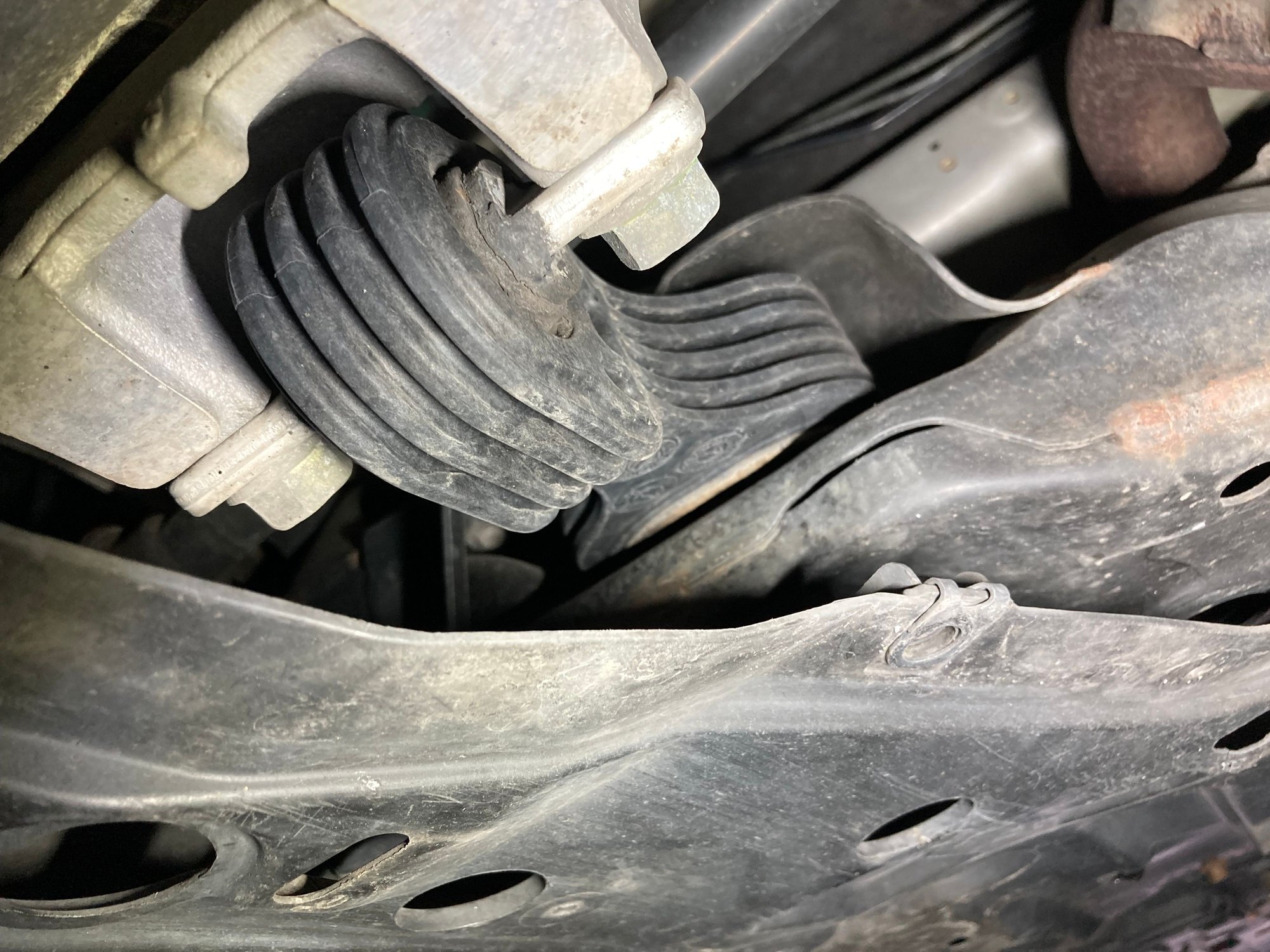

I was able to get the car up on jack stands today to get a view of the dog bone in the back of the engine. No noticeable issues, but I really couldn’t see the larger part that connects to the frame since it is blocked by the frame and a cover plate.

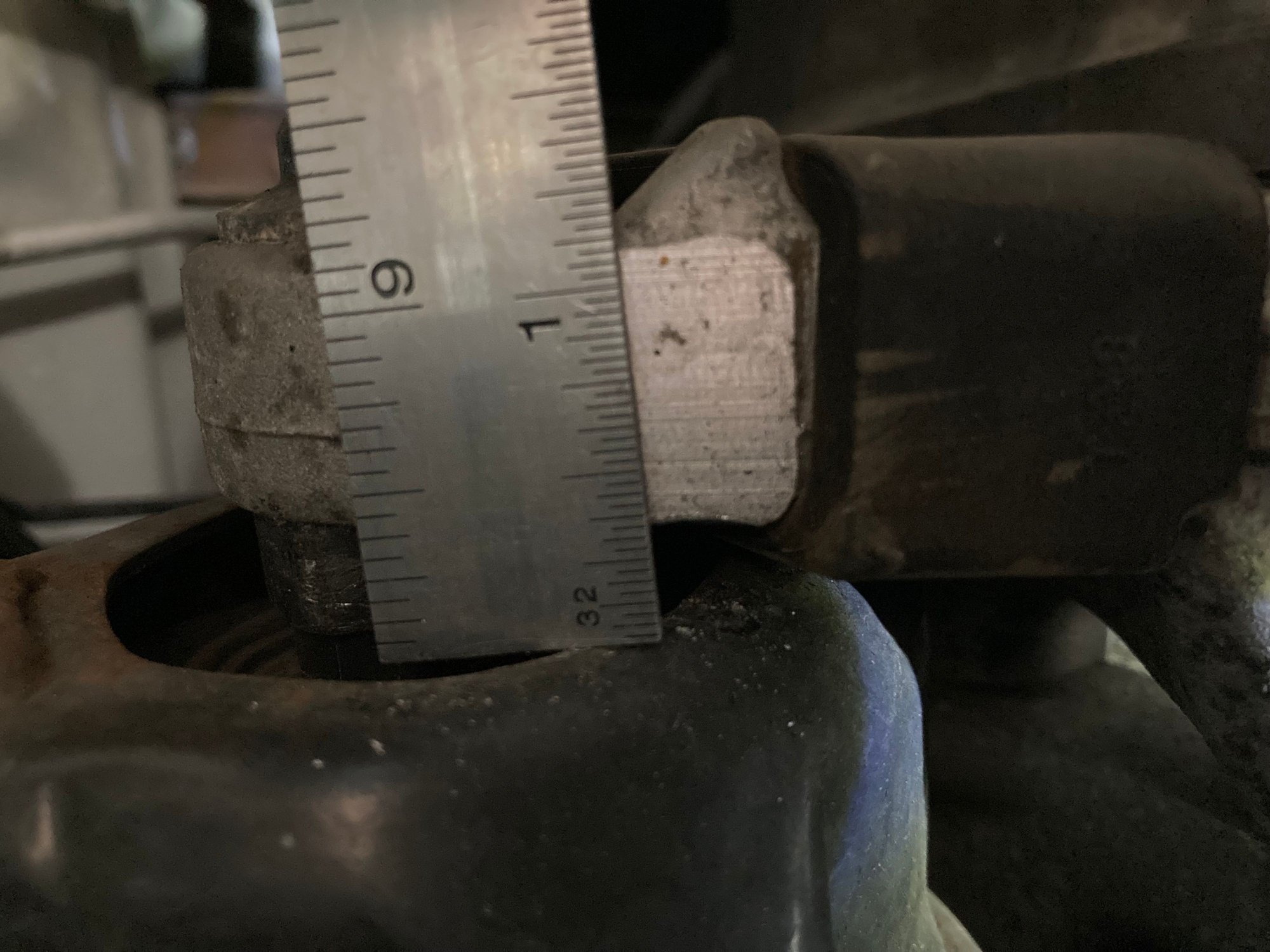

I did put a flat blade screw driver between the bracket and mount of the passenger side motor mount and can easily move the motor by just twisting the screwdriver. I’m thinking this is my culprit. I also noticed that the gap between the bracket and mount body is just under 3/8in. I wonder what a new mount looks like.
I think I will go ahead and replace the passenger side mount only for the moment due to time and budget constraints. I will plan to do the dog bone at the next oil change and the transmission mount in the near future as well.

I think those passenger mounts are known to fail and collapse. Maybe try an anchor brand mount?
