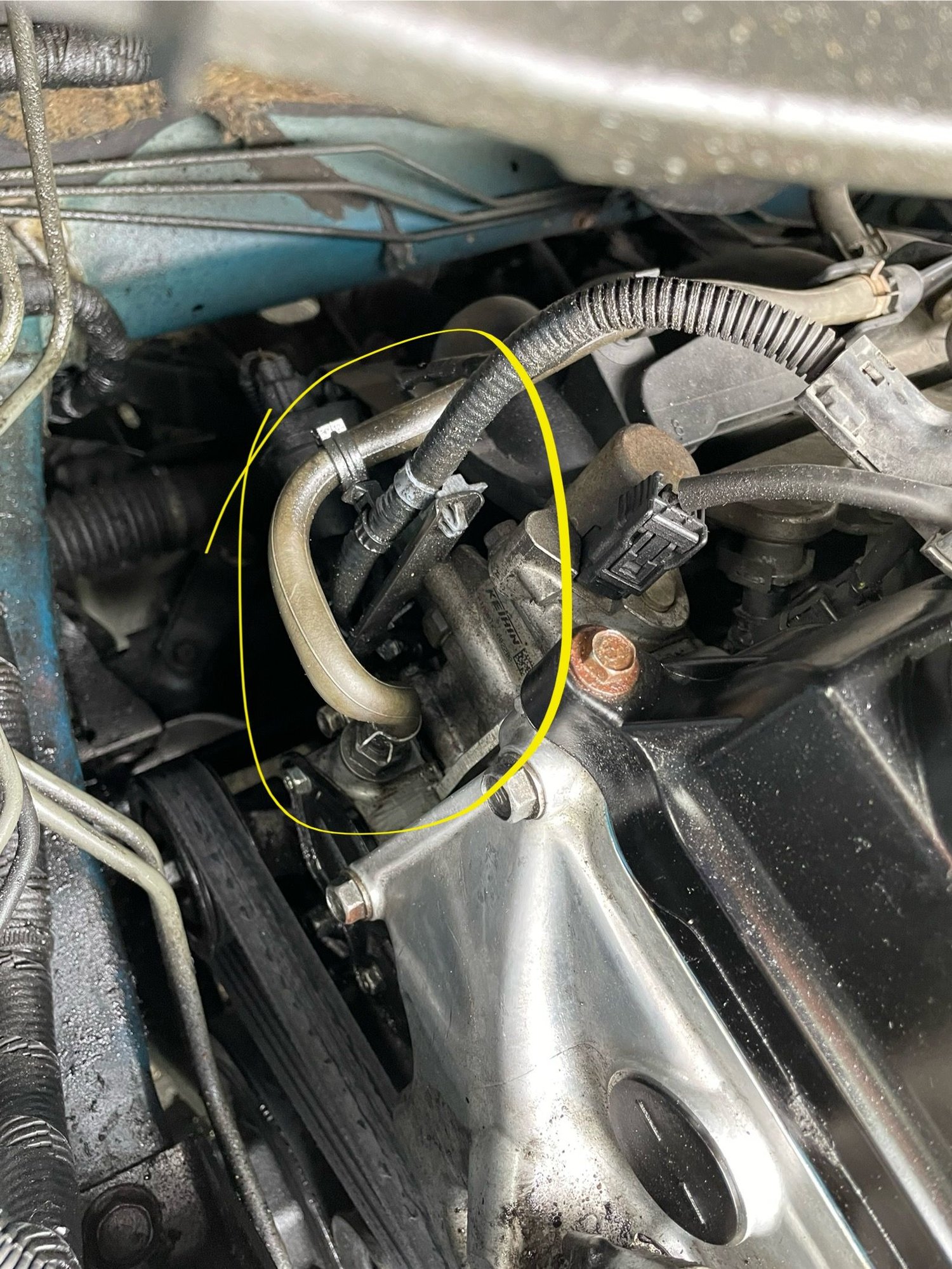

I’ve recently had some engine work don’t to replace a pulley and the serpentine belt, after it was all done I’ve noticed I’m leaking oil and leaking fairly quick and have had to add a lot to keep the level up, I’m new to this forum so I apologize for any errors I make. Help is really appreciated, it looks like it’s leaking from a hose maybe, where the hose ends it was covered in oil but I cleaned it up could anyone help in diagnosing what’s wrong and where it could be coming from? Thanks in advance guys

That hose runs from the PCV to the intake manifold. It may have oil mist inside, but should not be leaking actual oil. Other oil leak spots would be the VTEC solenoid (just to the right of your circle), or the valve cover gasket. It also kind of looks like there's oil spray all over the place. Like it's being thrown from the belt?
