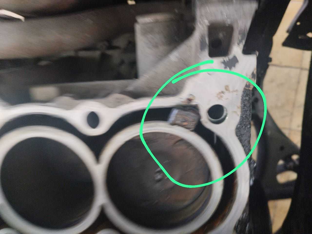

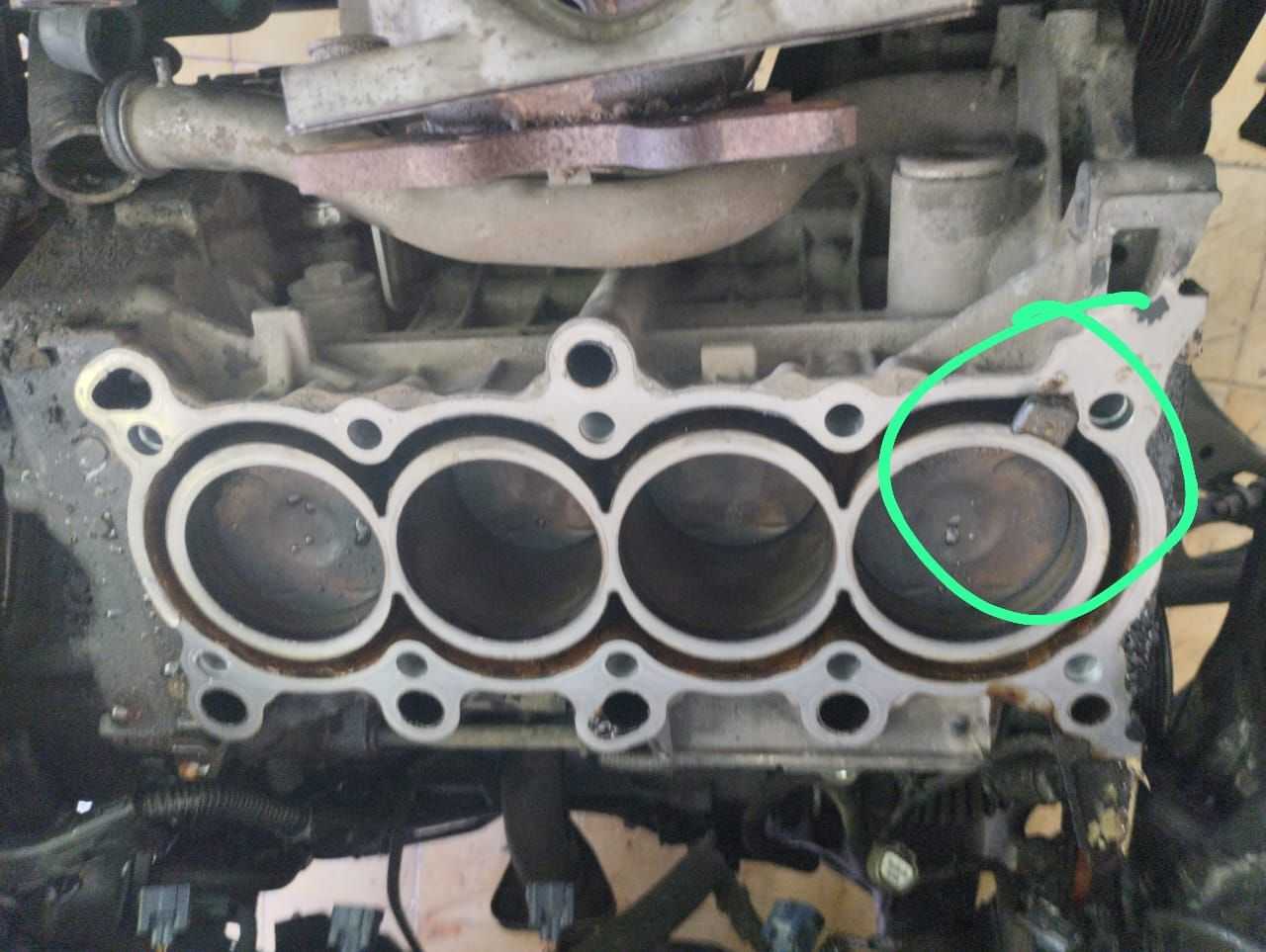

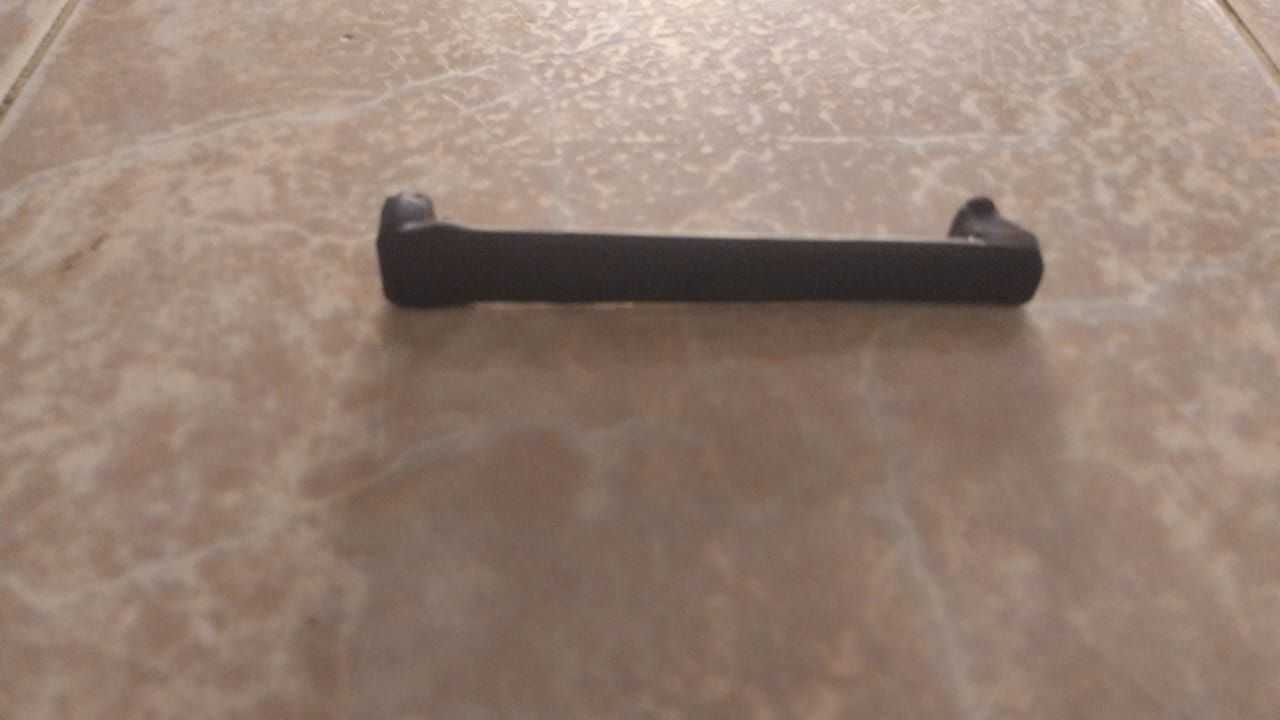

Hello i was disarming my first honda a CAME across this part what IS It called please.

It looks like a coolant diverter found in some K series engines. I've never seen a D series with one. What engine are you working on?
Edit: Lost track of what section I was in, thinking this was a D series engine. The R series from the 8th gen Civics do have one. Called a partition plate in the parts catalog.

IS a 1.8l i4 engine Civic 2006 lx R18 engine

Thanks for you response much appreciated, but i do believe is not that part in particular Is and internal one on the coolant part of the block, gotta put another Pic for better show.

you sure someone did not forget it inside in previous disassembly?

for a moment i believe that till i found this video at the 12:58mark there IS the part in there

I believe it's purpose is to divert coolant flow into the head. Or somehow limit hot spots in the water jacket. At least that's what I remember reading on the K series engine.

woah, that is... not sure how to say... just shoved in there? ...

Exactly just shoved in there and was thinking someone let in there but seeing some videos IS there too
