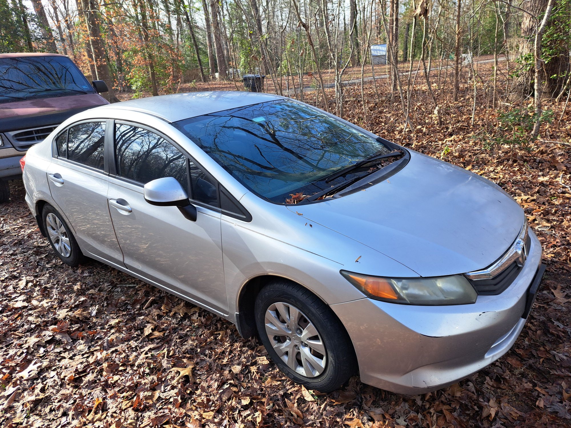

My mother is giving me her 2012 Civic LX which has sat for a number of months, and it won't stay running for long. Unfortunately my old Buick Lacrosse with the bulletproof 3800 bit the dust right after having the transmission rebuilt. Symptoms on the Civic are white smoke from tailpipe (coolant is very full), car wont run below 2k rpm, strong fuel smell after trying vigorously to start it, spark plugs are fouled pretty bad (but brand new NGK otherwise) and thats about it. I want to drain the fuel out of it and put fresh gas into to see if it'll fix the problem.
How does one drain the gas tank in these cars?

Probably easiest to take the inlet hose off the tank and syphon it from there. Although it sounds like you have some more serious problems.

Gor everything fixed. It came down to a chewed up fuel line and chewed up alternator line. Runs smooth as can be and I'm averaging 29mpg in town. Waiting on a wheel lock key to arrive so I can buy a used tire for one corner and take her on the interstate.
