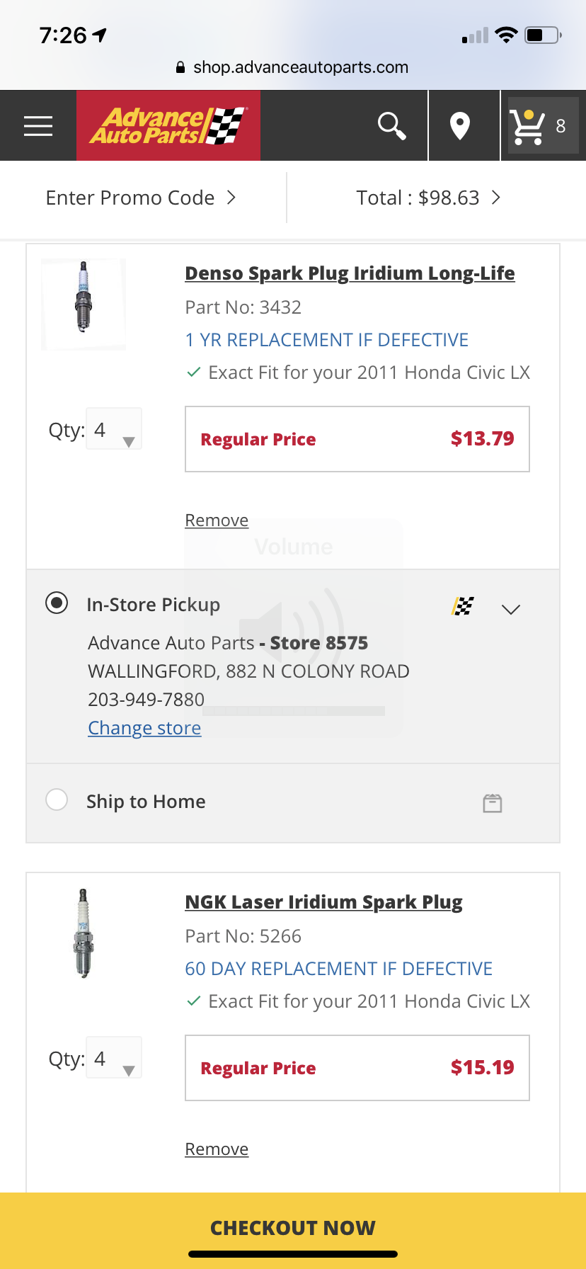

My civic has almost 170000 miles. Bought it with 32000 and I haven’t changed them yet. Car runs great. Should I change them? Or maybe just pull them and inspect. Should I use any anti seize if they look good and am just putting them back in
https://shop.advanceautoparts.com/p/...266/11000222-P
I’m pretty sure these are the ones I need.

Yes I would replace to keep combustion optimal. You may not have "issues" at the moment but 100k miles is the typical life from an iridium plug.
I have never used anti seize on plugs personally and I think NGK tells you not to on the box because they already have a coating on them.

These are the recommended plugs correct. Any thoughts on which brand I should go with. I just got the spark plug socket. So I’m ready to go.
amazon has the oem NGK plugs $25 each. Why are these so much more? Just because it says Honda?

Go with the ngks

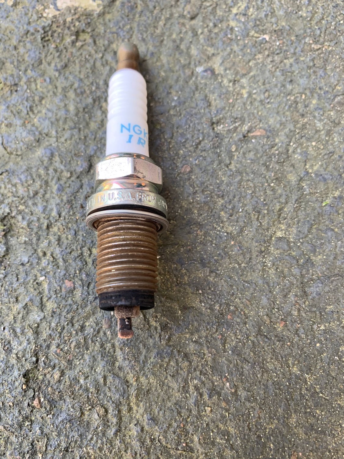

Just replaced plugs. Went with ngk’s. Super easy. Took 15 minutes.
The old old ones all looked like this:
Glad I did it. They looked pretty rough. Of course with my experience they could be fine. Car stated right up.
