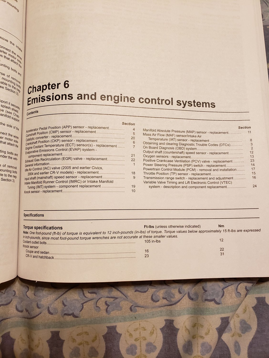

Yep, this was my thinking too, so I'm going to have it rebuilt regardless, if I can find a shop. Anybody know what the torque specs are for the knock sensor?

Re: Starter issues?
01 to 11 haynes manual

Re: Starter issues?
Thx Captain! This would indicate 16 ft-lbs for my '07 Civic Si. I've read conflicting specs elsewhere stating either 15 ft-lbs (close enough!) or 23 ft-lbs, which is also indicated in your Haynes excerpt, except not for my model. Seems to be a lot of confusion out there, so I presume people must be mixing models when they give their specs.
Thx again!
