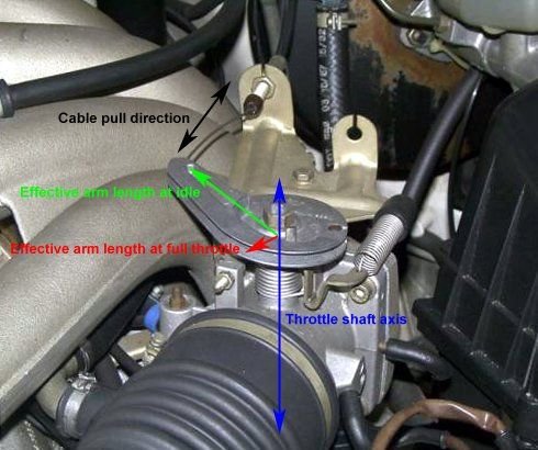

ezone...I came across this article ( http://tiny.cc/shudder-jerk ) Could it be a dirty throttle body and / or throttle position sensor causing the issue?
Old Jan 26, 2018
  #54
Re: 2012 Shudder & Jerk
Oh boy....
This article applies to the Honda Civic (1992-2000).
If you have an OBD-II scanner, connect it to your Civic's ECU, which is located behind the kick panel of the passenger's side foot well.
Um....not quite like that.
You might not realize it, but this particular picture is the TB of an old Porsche 944...a far cry from any Honda
Article link includes same image without text: http://www.dietersmotorsports.com/te...rottle_cam.htm
Their loose engine mount picture is from a Civic far newer than the models the article is directed at.
Did someone just use google image search when writing their article? Sure seems like it.
Can't say for certain, but I doubt it.
Your car has throttle-by-wire, you might cause more problems than you bargained for if you mess with it.
