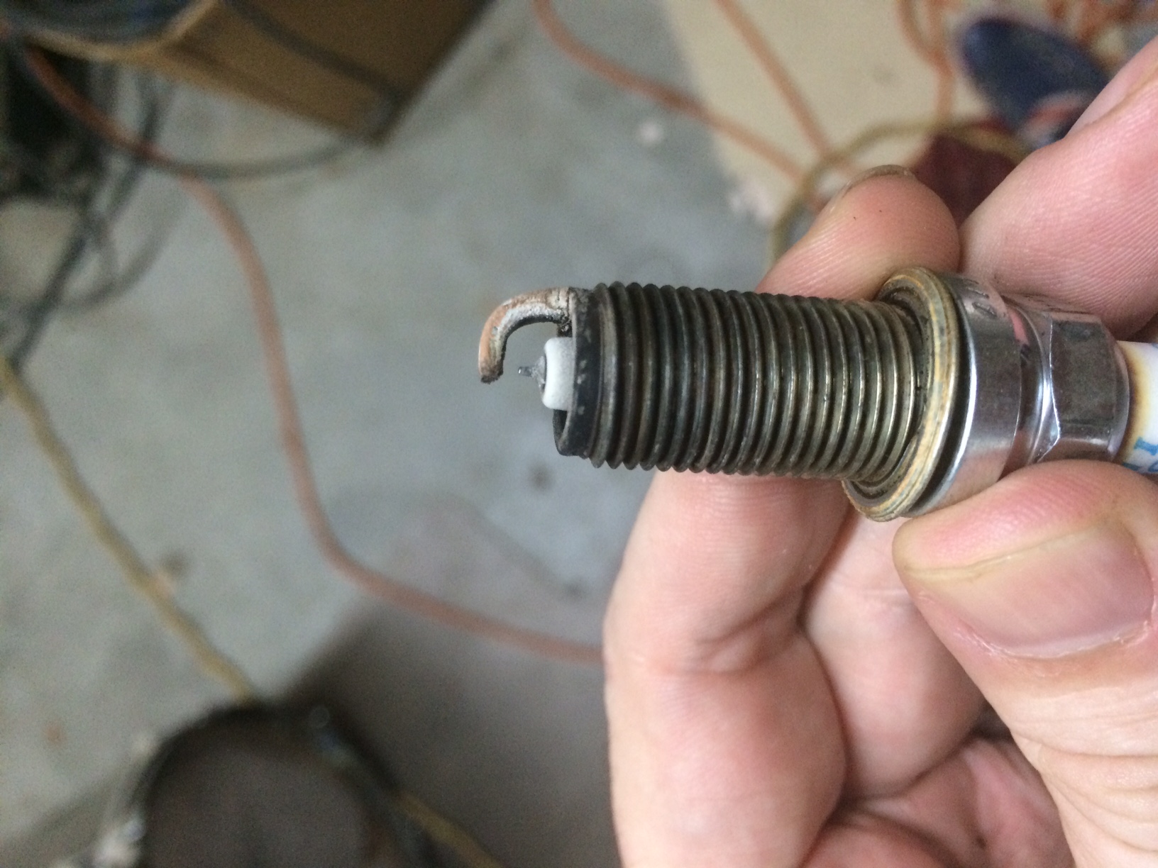

I've got a 2006 Hybrid with I think 140k+ miles on it. It's a commuter, about 70 miles a day.
A little less than a year ago the car was having a very intermittent, very light sort of sputtering. No CEL. Still intermittent, the problem continued but the sputtering at times was more severe. I noticed it more on acceleration at slow speeds. Still no CEL. The problem seemed worse in Oregon on the hills, if that matters.
At some point in time (it's maybe been two or three months) I replaced the spark plugs. I just replaced the 4 easy to replace plugs. There are also 4 more on the hybrid that I think does something with the exhaust recycling (hopefully that makes sense) which I did not replace because they are a pain to access.
The new plugs (they are the E3 plugs with the different tip) seemed to fix the problem, but for about the last month it started to happen again, so the new plugs only lasted a few months before the problem happened again.
After getting my oil changed at Goodyear they said it needed an induction/fuel cleaning. I'm not fond of having those places service my car because I always feel like I'm getting ripped off. Anyway, I did add fuel cleaner to the gas tank. No help. Should I do more to clean it? I have Seafoam, but a bunch of forums said don't do Seafoam for newer cars.
Finally the CEL flashed towards the end of my drive. It flashed 25 times if that matters.
Hopefully the sputtering is on okay description. I guess maybe it feels like a cylinder isn't firing? I'm THE WORST at describing or diagnosing problems.
Any ideas of what it could be or how to diagnose it? Any thoughts on what it might be?
Thanks for the help!
Use the correct DENSO or NGK plugs, not cheap gimmicks.
Flashing CEL = misfire
Read codes, figure out which cylinder the misfire was on
pull BOTH coils and plugs for that cylinder (and keep them in order)
Inspect for carbon tracking on the porcelain of the plugs
If you find this, replace the plug AND ITS COIL at the same time. Don't change one item at a time, because one track mark will cause a burn in the other no matter how new it is.
If you don't find this, then you may just have a bad coil. I mught swap the suspect coil to another cylinder and see if the misfire code moves to another cylinder....but on an 8 plug engine it's trickier. Move front coil to another cylinder, and move rear coil to yet another different cylinder. (make notes, keep track of all this as you go!!) Then see what misfire code comes up next.
