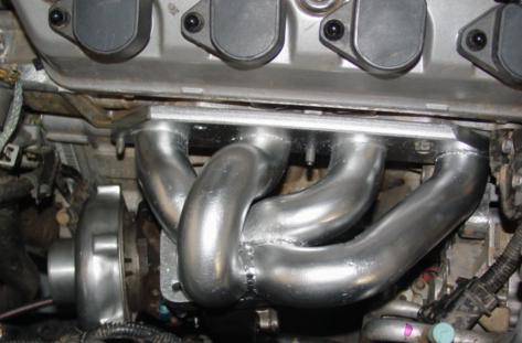

Here is the picture of the manifold and turbo
So this is your turbo'd civic? Strafford Fabrications do yours as well? How do you liike it? Any problems? Any numbers? Thanks

Yes, that is THE stafford fab. kit. We are Chroming the intercooler piping so we will have pictures of that later. I just posted this so some people would be happy about the manifold, since it is the hardest part.
