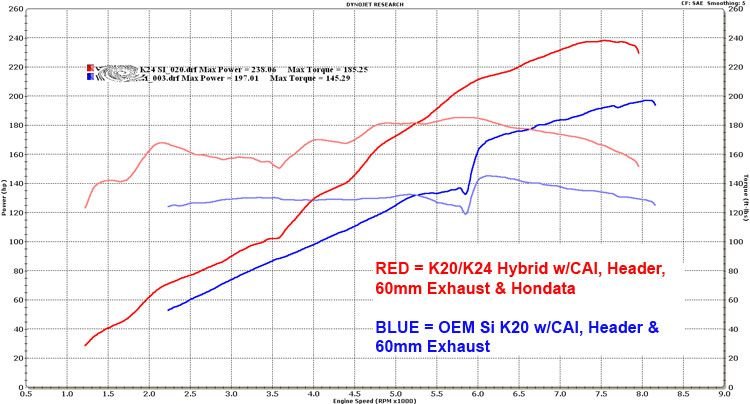

K24 doesn't really lose power up top, they both make ~200 HP stock. The K24 just makes a lot more torque down low and doesn't rev as high (500-1000 rpm less).
I swapped a K20a2 into my EM2 back in 2016 and then did the K24/20 about a year ago. The car got noticeable quicker in all areas. With the K20a2 I was using a stock tune, with the K24/20 I was using a stock K24a2 tune. All parts are OEM so reliability is still there.
Here's a dyno graph I found comparing a K20 and K24. Not a direct comparison because the K24 was tuned but you get the idea. In my opinion, there is no reason to use a K20 unless you want to rev to 8k+ with a stock engine.
