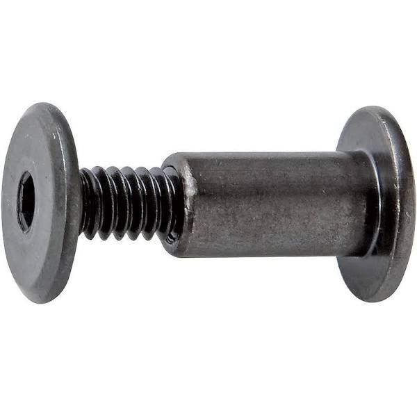

I just drove some connecting nuts/bolts through the visor on my ex's 08, enough to clamp down around the hinge part. Cost me like $5 and about 30 minutes to do a quick and easy fix that wasn't too obtrusive.
used 3 sets of these for a flush-ish look, and it's still holding fine and letting the visor operate normally to this day
Bought some bronze ones to be a bit less obvious compared to the tan inner color

Thx for this, $5. is doable!
