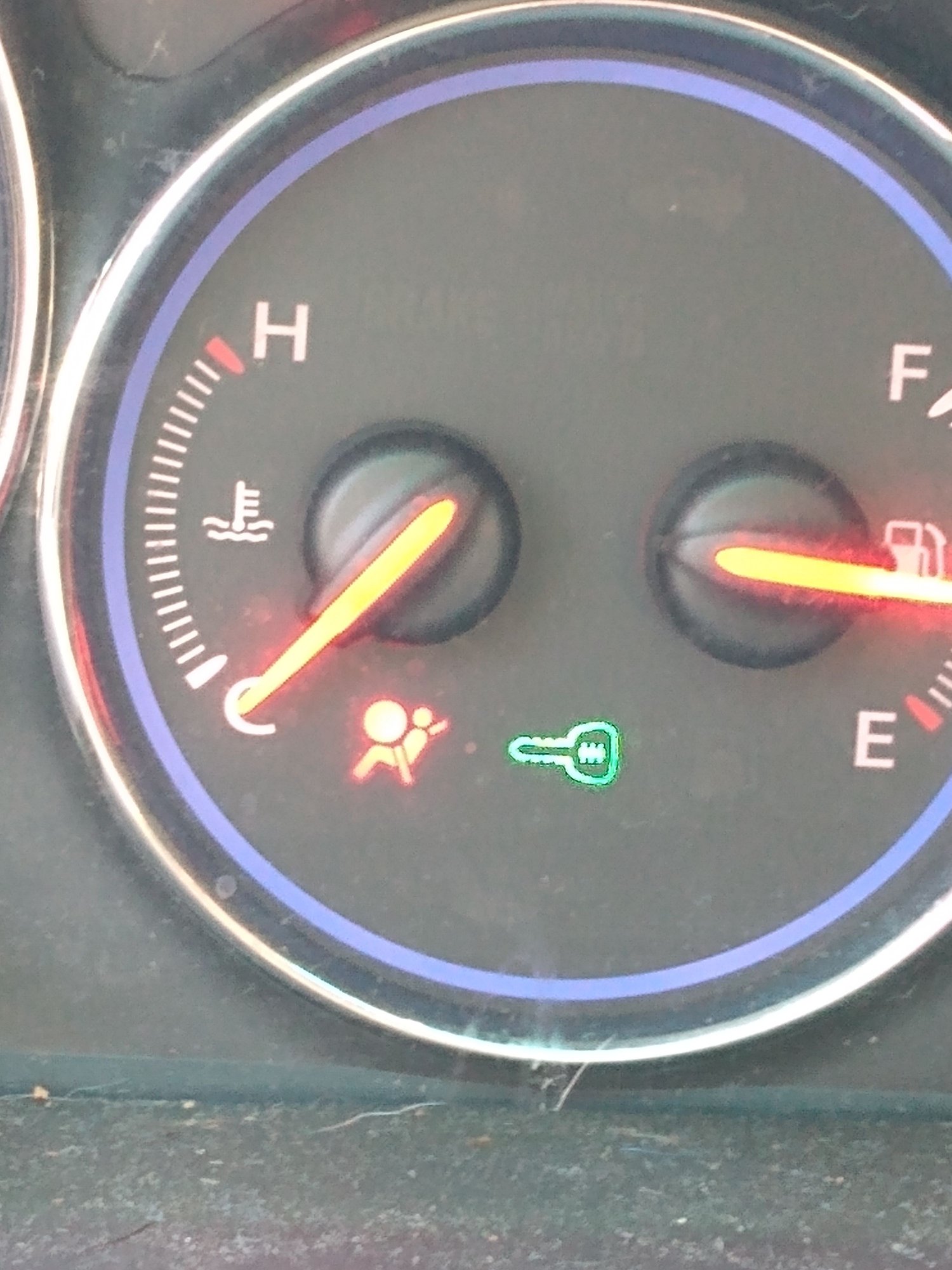

Ok...fully put back together...green key is flashing when trying to crank
Old Jun 15, 2021
Rep Power: 513
Re: car won't start after ignition cylinder repair
It's an immobilizer issue then. That key worked prior to the ignitioncylinder repair?

you will need to call a locksmith that can program the key to the ECU
