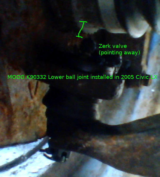

Sorry for my couple week delay. I installed ball-joints on the car. I actually subsequently replaced both CV axles (trying to eek out a tugging oscillation due to steering that turned out to be from the super worn tires and my original axles were fine). In the process I even let the knuckle/hub assembly slip out of my hand (not attached to strut) and crush the ball-joint boot a lot... this time, with the groundward pressure relief area of the boot blocked by the LCA grease seems to have escaped out the top. Surprisingly the boot survived the abuse unmarred.
Regards to the above quote, I DID leave the zerk fitting on (that came with the MOOG K90332 ball joint) even though it also came with a flush blug fitting. I verified it clears the axle on my particular vehicle and just took a picture for anyone interested. Anyway, thanks again to people rapidly answering my question a few weeks ago.

huh, is that with the car lifted or with the car on the ground and settled? the suspension clearances will be a lot tighter with the car settled after a couple of drives...

I actually lifted it and dropped it suddenly and there was decent clearance at all times. The zerk valve and CV cup barely change in relation to each other while the angle of the LCA changes. I did just put on new KYB strut assemblies which give the vehicle at least a couple more inches of ride height than the very low sitting 250k factory struts. I don't know how much that could affect this issue, although for now I still have plenty of clearance. I don't know what else to say, but I seem to be good to go. Thanks for warning me anyway!

Good!
Keep an eye, new struts tend to get lower over time (2 weeks to a month?)
if it get lower, check again the clearance. I think I have seen a few years back that the zerk fitting did machine a groove into the axle, so be aware of that...

I installed those same ball joints on my car. I did as the instructions stated by filling with grease and then re-installing the cap. However, it really seemed like the 90 deg zerk fitting would've fit with enough clearance (barely, but enough).

So far so good. The struts have settled a little and it still looks fine. The geometry of the knuckle seems to more or less fix the position of the top half of the ball joint with respect to the outer CV joint cup. The more I think about it strut settling or even struts hitting a massive pot hole shouldn't change this orientation much / or even at all. Different generations (before 2001 for example) could be a little different but on my car I feel the Zerk fitting has good clearance left in.
