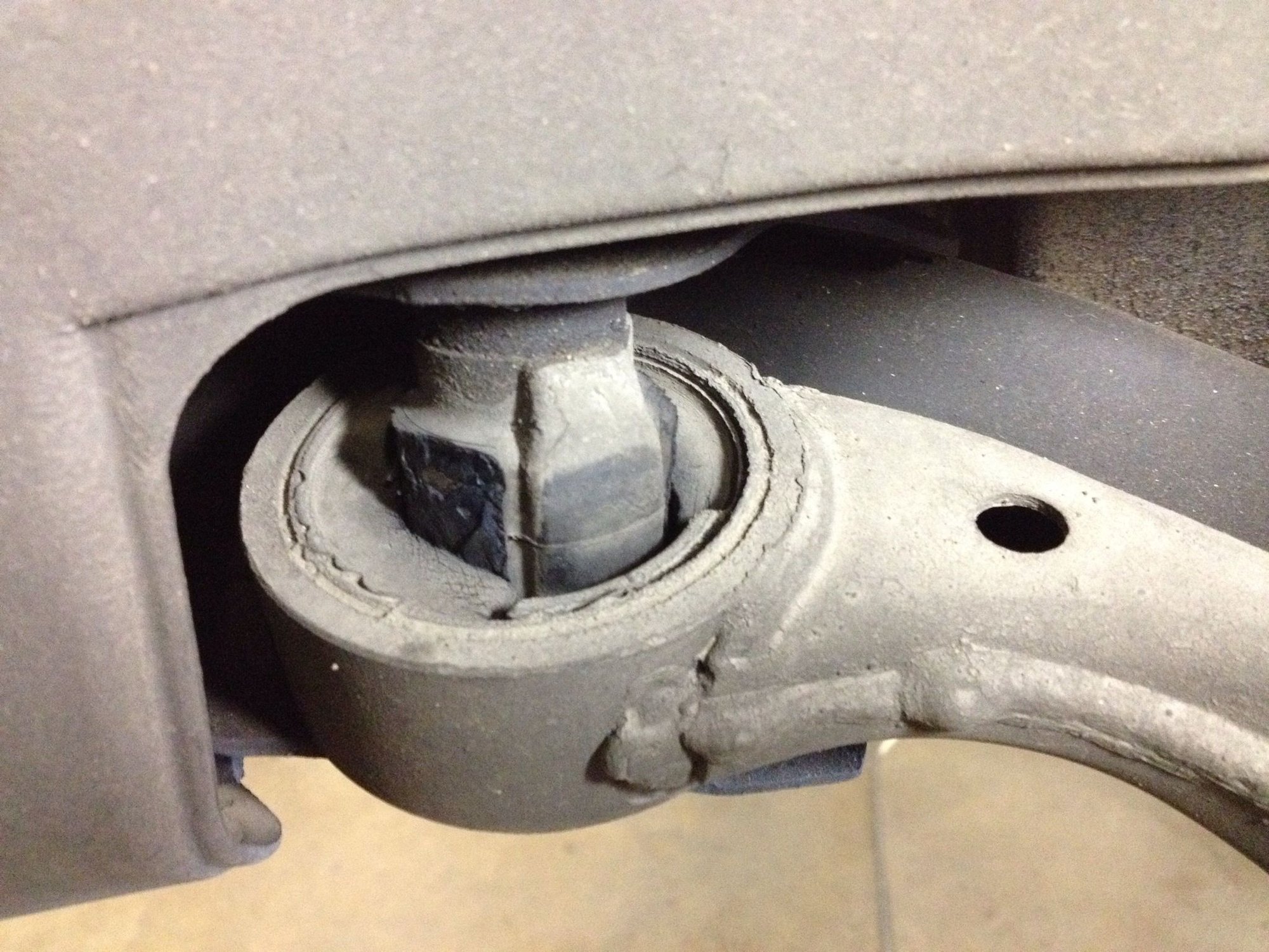

Front bushing is supposed to be easy to move, the center is only connected with the two strips of rubber.
It looks like the two parts of rubber on your bushing are not torn badly yet? Difficult to see in the video.
If its rubber were torn completely apart the forward end of the lower control arm would be able to move freely up and down and make unwanted contact against the subframe (clunk noise) upon bumps in the road
Found this pic of a badly torn bushing on google image search:

The front one is starting to rip in the edge. Further, the rear one is completely ripped.
So, these things could cause the issue (clunk noises) when hitting or passing through a speed bump?
One more time, thank you so much.
Re: Noise with genuine shocks
Torn rear bushing could be a possible cause of noise, yes.
I believe your forward bushing has not yet ripped badly enough to allow the arm to drop and contact the subframe.
But you already have the control arm out of the car so if you intend to replace one bushing you may as well replace both.
Be sure to neutralize the control arm upon reinstallation so the new rear bushing is not preloaded causing premature failure.

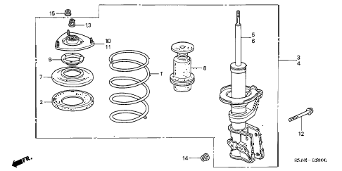

When assembling new front struts/springs etc., did you install a new stopper (bump stop) to the shaft of the shock?
If this parts catalog image displays correctly below, it is item #8

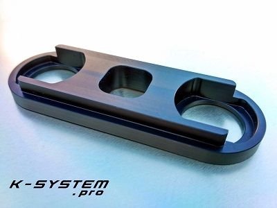

I have replaced the rack slider with these one 6 months ago:
I have recorded this video
You will need someone sitting in the car turning the steering to produce the noise while you search
