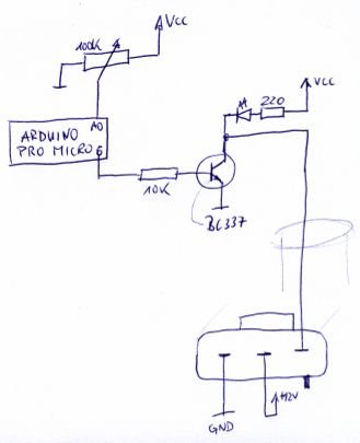

Using an arduino board I was able to test the valve though, connected approx. like this:
I'm not sure I got the pinout correctly, but the valve follows nicely the potentiometer. If I went below 10% duty cycle or above 90%, the valve went back to the default position.
Exchanging GND and the PWM signal also worked, but the usable range was smaller and it was not possible to close it completely.
So I just cleaned the IAC valve and put it back.
