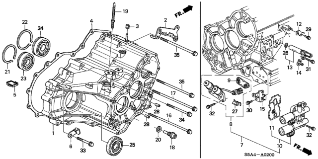

Hello all, I'm trying to find the part number and location of the input or mainshaft speed sensor for an 04 Civic DX. I am getting code p0717, I took it to a trans shop and he said there's nothing wrong with it, just replace the input sensor. I am having a bitch and a half of a time trying to pinpoint exactly what I need and where it is.

On the backside of the trans near the differential. Probably better to grab a used one from the junkyard instead of a new aftermarket one

Ok so I got it figured out finally. The sensor is on the front of the trans under the battery. The part number is 28810-p4r-003 its called the main pick-up assembly. Number 13 on the diagram.
Hope this helps someone!

Sorry om the manuals its on the back
