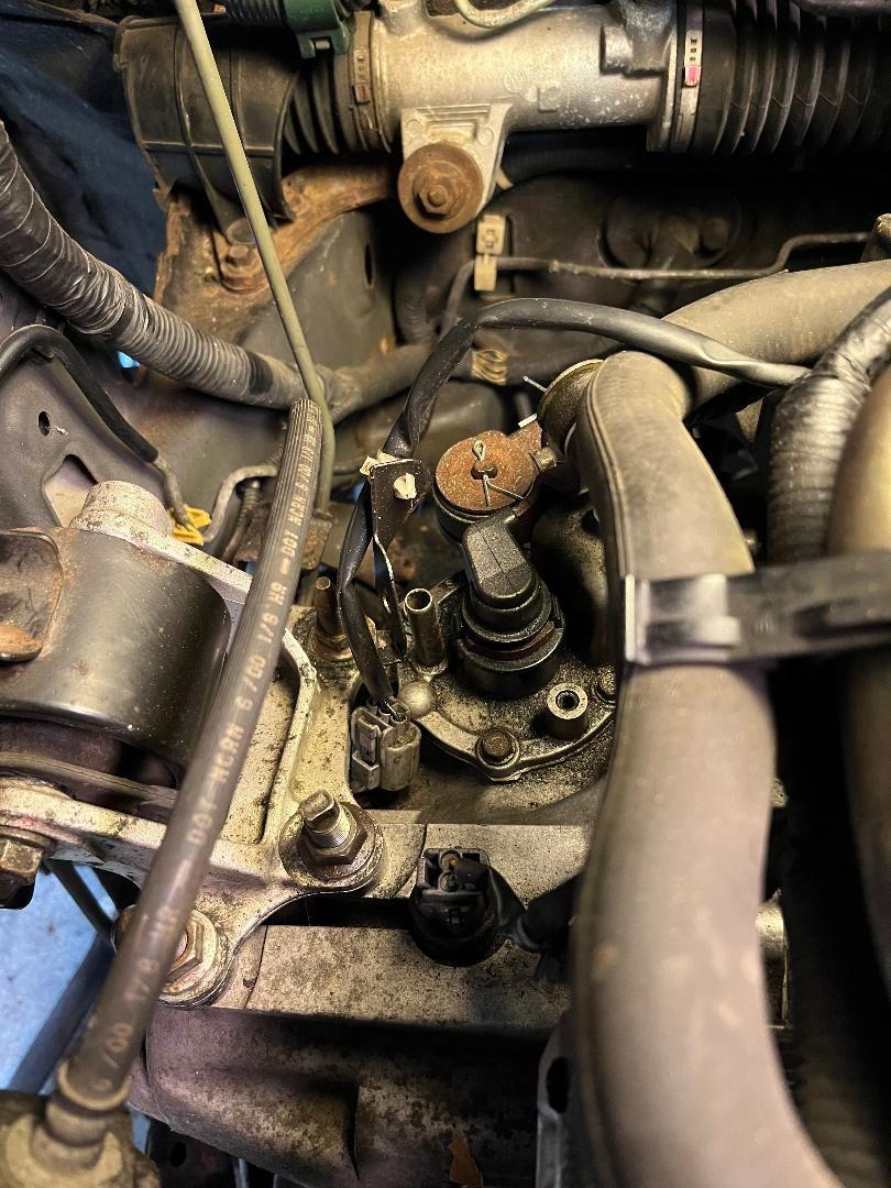

I replaced the clutch on the car when i got it and just can't remember where the vaccum line was hooked to or where i put it. Could anyone tell me? 5th gear was popping out after i gave it gas so and i'm hoping that was from low fluid.

There is no vacuum line on the trans

Im not sure what the hose or line to the left of the gear selector goes to or what it would look like. I tryed to find one at a picknpull but they only had automatics there. Does anyone know what that goes to?

That's the vent tube, there's a little cap that should be on it. An automatic vent cap will probably fit
