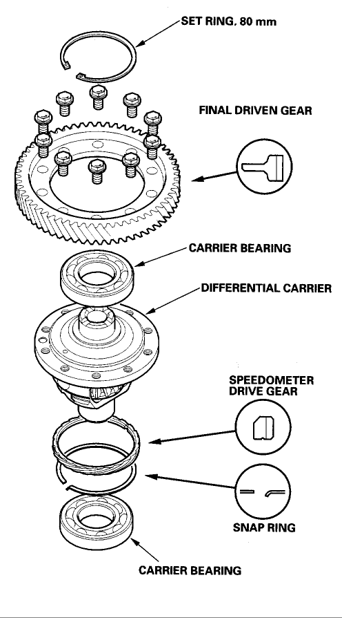

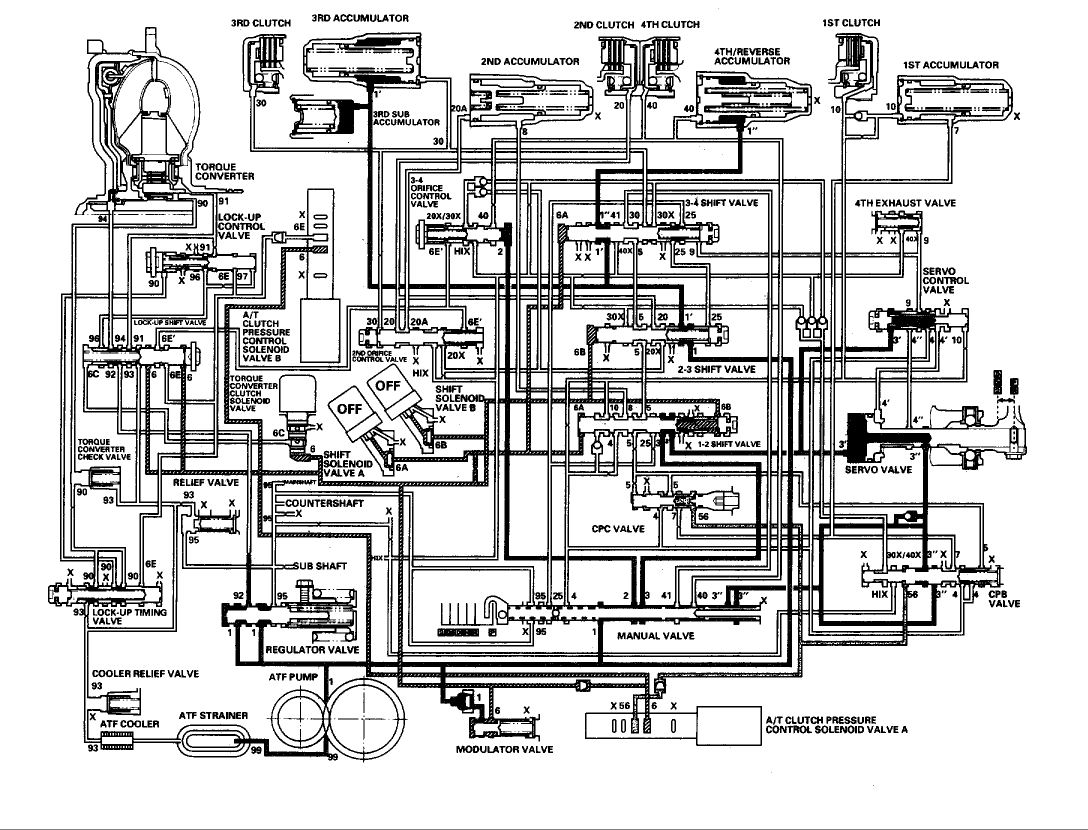

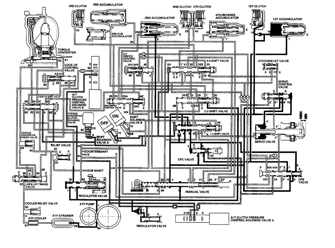

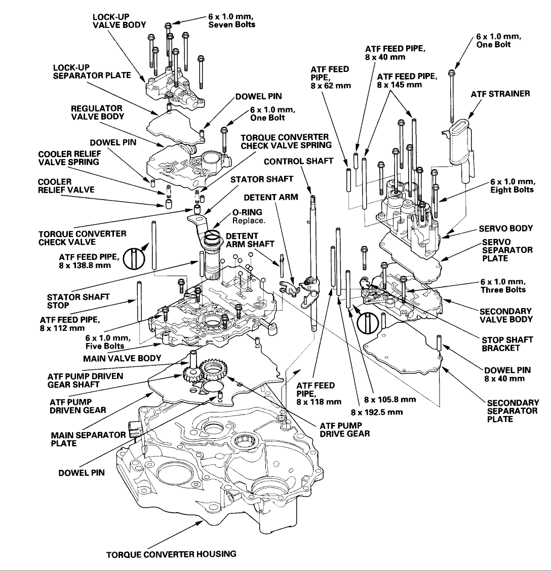

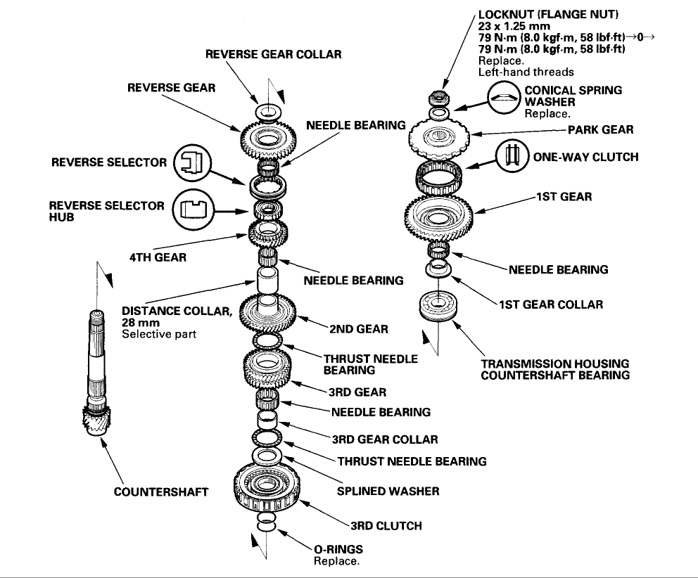

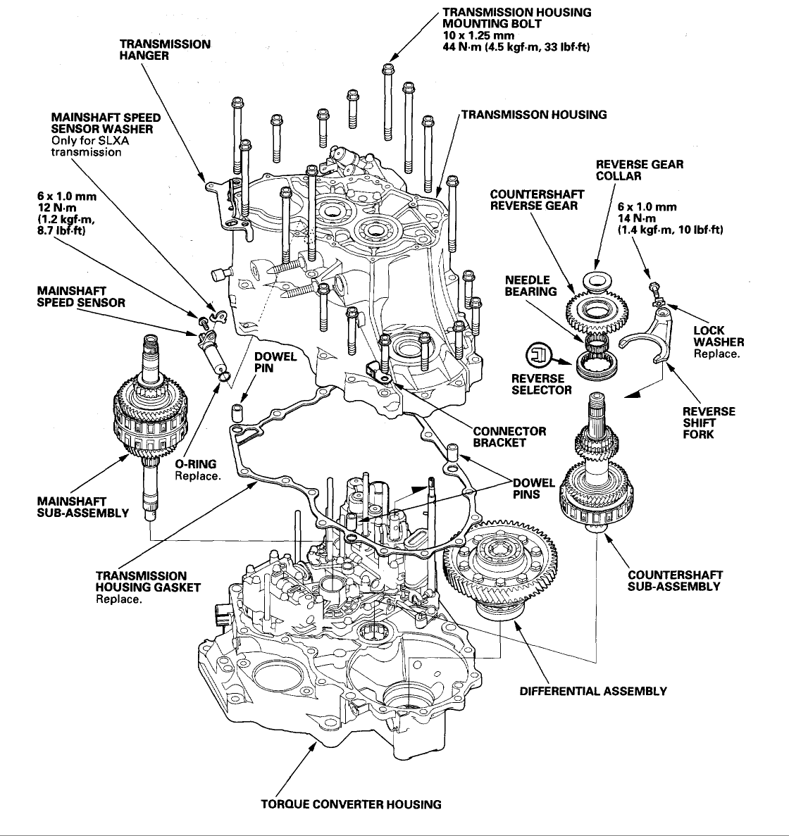

I have much more available if needed. I have rebuilt mine a couple times as I keep doing stupid things such as flipping reverse gears wrong or the engagement ring for reverse. I know, I know- but I have talked to trans experts and have been through this thing enough to dream about it. I am posting this because the info is so spread out and incomplete. Hope it helps! Happy building!
