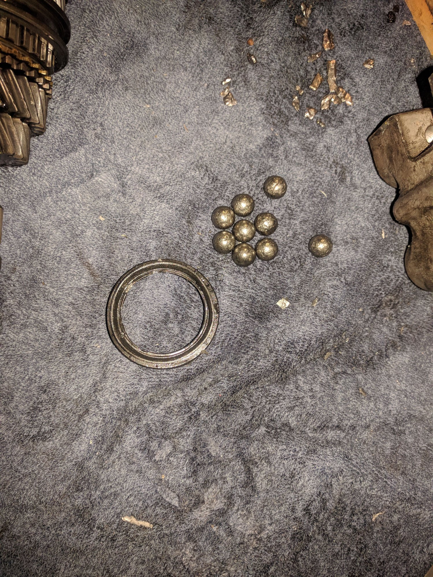

So I got the transmission removed and split apart and it turns out that that the input shaft bearing looks ok (I'm still going to replace it). But the output shaft bearing underneath the differential was SHREDDED. Only the ***** were left... Only problem is that the old bearing is stuck on the underside of the differential. Any ideas on how to get it off? Do I need a press?
Got pictures of the damage and what you are trying to do?
If it destroyed a bearing and the internal magnets didn't catch it all, just think about all that metallic debris that's been circulating around in the oil acting like a sandblaster or a rock tumbler.....

I would put the whole differential in the freezer overnight and then use a cheap torch to heat up just the bearing and that usually is enough to get those kinds of bearings off. To install, put the bearing in oven at 200 15 minutes before install and again a frozen differential fresh out of the freezer.
I would be very worried about what kinds of damages have been done with all that circulating around. You know how the smallest pebble can jam up a shopping cart wheel, same thing goes for small bits loose metal getting inside a bearing.
How does the magnet look?

A Fry Baby/Fry Daddy filled with 80w90 gear lube makes a whole crapton of stink and makes everyone in the shop puking sick. Yes we used to do that at one shop where we did a whole lot of trans work LOL...but a hot bearing can sliiiiiide all the way home onto an ice cold shaft or whatever.
Lift the differential out and grab it?
Got pics yet?
I like to use a cutting wheel to slice into an inner bearing race....then crack it with a cold chisel. Once cracked it should slide right off the shaft or carrier.
I don't want to torch one except as a last resort, if you take the temper out of it it's much harder to crack it.
If you heat too much you could take the temper of of the shaft(s) and that would be bad.
If you are trying to get an outer race out of the trans case, there are pullers for the job. Maybe it can be rocked out with a small ladyfoot. Watch out for shims behind the race.

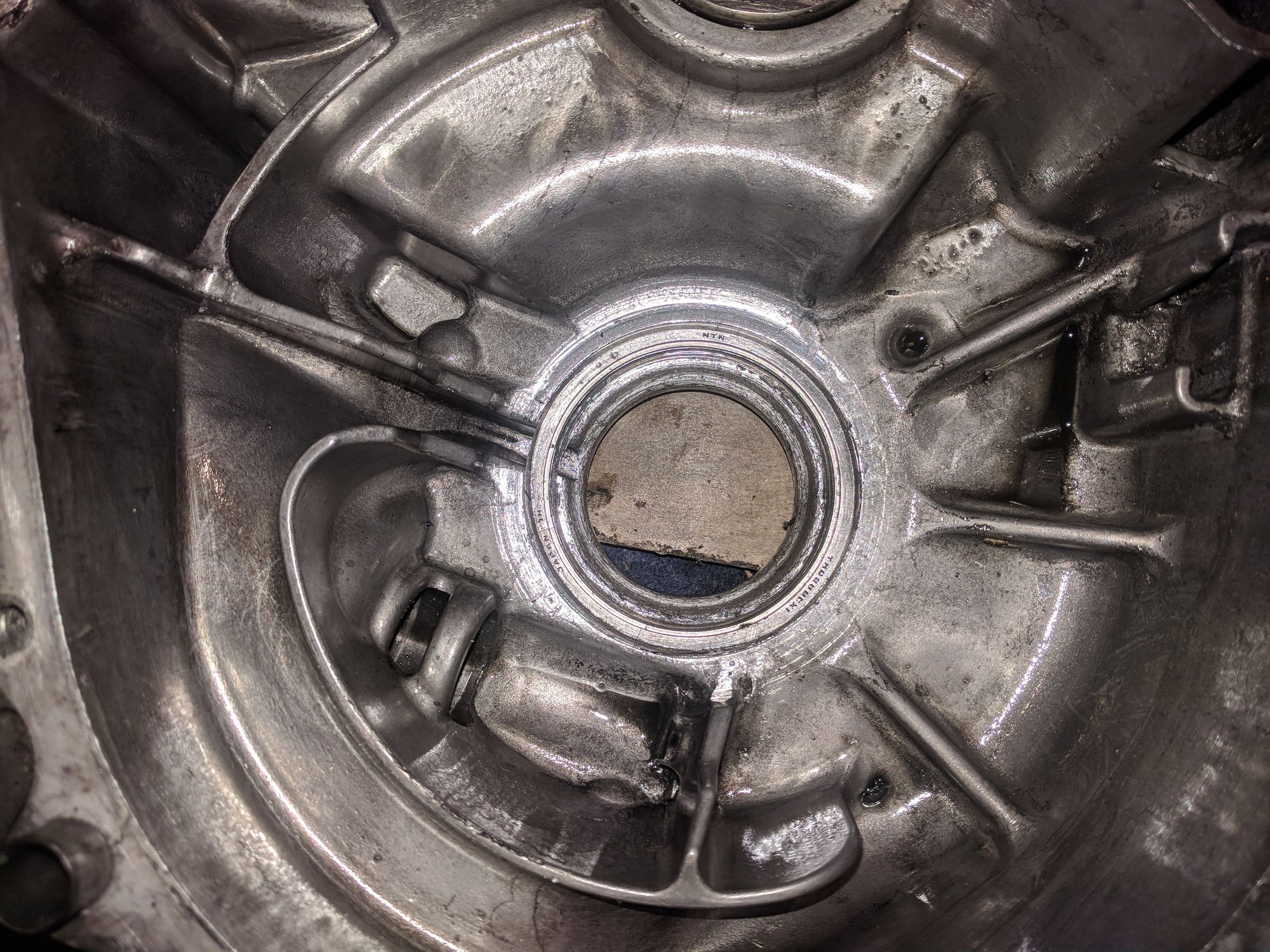

Everything inside the case looks okay, all things considered. The magnet had quite a bit of shavings/sludge- like material on it. There were a lot of metal pieces on the axle side, even seemed like some got wound around the axle shaft. Oh, and the speed sensor was cracked (it hasn't been working since around the time the noise started).

That case kinda looks like it's loaded with debris, is it non-magnetic aluminum?
Still have the inner and outer races to contend with.
Slice and whack to remove the inner, or use a regular 2/3 jaw puller?
and an inside jaw puller for the outer race.....but it might just drop out or tap/pry out with little resistance if it's perfectly square with the bore and relatively undamaged
