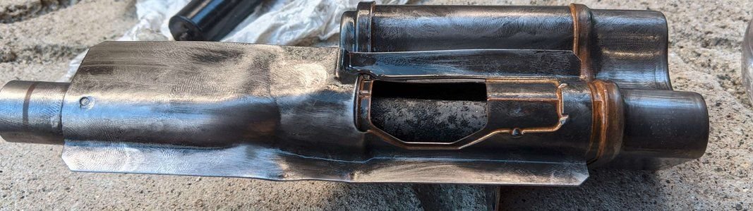

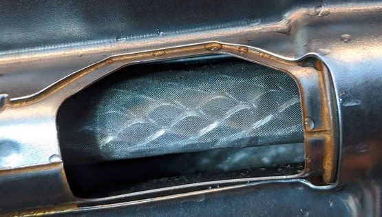

Anyway my goal now was to dig down to the filter/screen and clean it since online searches and research indicated that was likely the problem... The filter has become almost clogged and when the vehicle is driven debris can get picked up and it clogs the filter enough to cause a drop in oil pressure so the transmission starts slipping in all gears. By pulling over and turning the engine off the debris has a chance to settle back down into the bottom of the transmission and the car can be driven for a while again. THIS did turn out to be the cause of my trouble. Here's a picture of my dirty filter:
Here's how it looked after I cleaned it. I used engine degreaser and also carburator cleaner. I ran water through it backwards and managed to dislodge most of the crud. I also wiped as much of the screens as I could get to with a q-tip. It wasn't perfect but it was very much better.

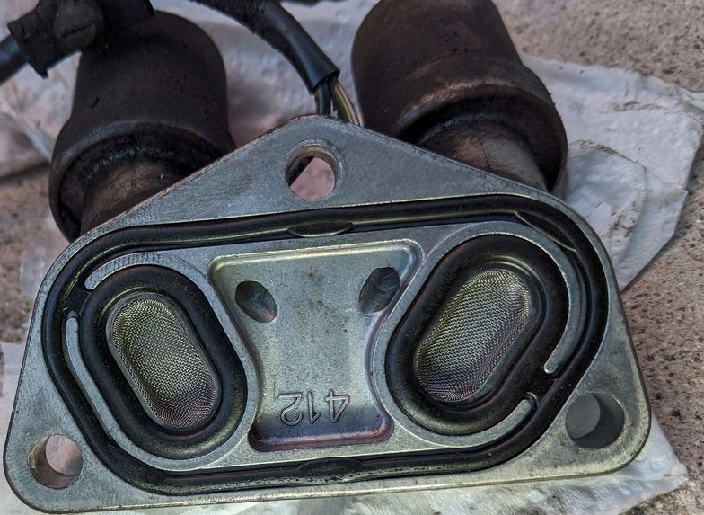

While the transmission was out I checked the other solenoids. Most of them had debris trapped in their own little filters:
And after cleaning:

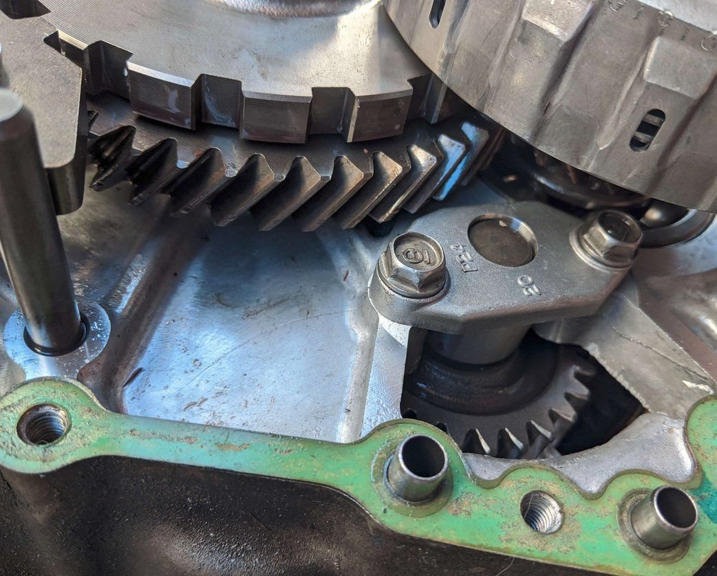

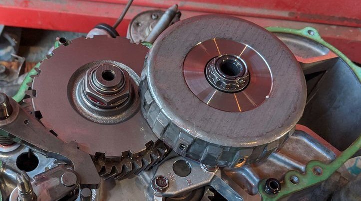

Ok now getting it back together was also a problem because the bearing on the main shaft was a press fit. I stupidly tried to force the middle case back down by using the bolts themselves. I got the case in place and then went around and around tightening up the bolts, forcing the case down. I assumed the case could handle the stress of pressing the bearing down but it couldn't. I heard a very loud snap, or more than one, and I luckily noticed I had cracked the aluminum case around the bearing... I was ready to give up and just buy a junked transmission but instead I loosened up the bolts and let the crack close up. I figured I had nothing to lose if I got the transmission back together, maybe it wouldn't matter. Here's a picture of the crack... I didn't take a picture of it when it was widest open, unfortunately.

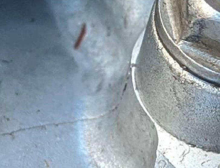

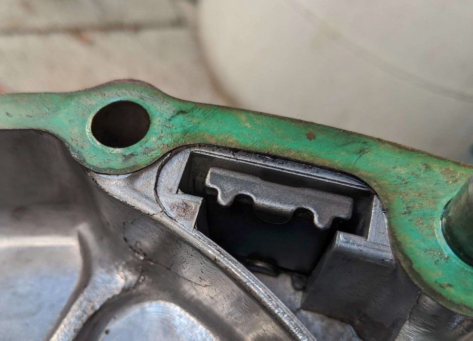

You can find the crack by locating the P24 stamped on a plate. Then look at the bolt to the left of that, then look down the aluminum side. Here's a blowup:
You will see the crack extends in a curve to the left and down. That was maybe 1 mm or so apart when it was at its widest. It seems to have closed up well enough though.
I felt stupid trying to use the case to press the bearing onto the shafts. When I saw my error I loosened up all the bolts (as mentioned already) and then figured I'd use the gears and clutch assemblies themselves to pull the shaft(s) up through their associated bearings. See here:
The left one goes on first, I think. I did remember to pound the metal into the slot so the big nut wouldn't come loose. I then did the same for the right one. It might also work to get the two nuts in place and tighten them up slowly together. As I recall the left hand shaft didn't offer any resistance, the right hand shaft and bearing was the troublesome one, which is the very one the mechanic just pushes out with his thumb...
I had intended to hone out the inside race of the bearing a bit but I decided not to. I was worried about getting grit and metal dust down into the bearing.

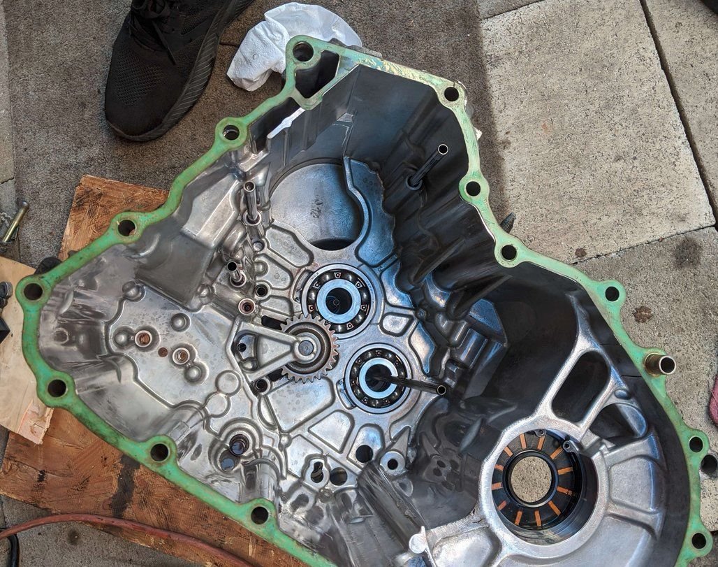

Oh... The previous picture is the magnetic trap that is accessable when the middle case section is removed. It's actually on the middle case section, you have to look at the bottom surface to see it. Here's another picture:
Unfortunately the magnet isn't visible in the picture, it's in the part off the bottom. This is looking into the middle transmission case section after it's been pulled off the bottom bell housing section. We can see the underside of the two big bearings. While the transmission is open you should pull that magnet trap out and clean it as well as possible. The drain plug also has a magnet. When I first drained the transmission I noticed the plug magnet also had thick black goup on it. I wiped it off onto a paper towel and confirmed it's a fine clay composed (I assume) of magnetic steel filings. The magnet was also coated in the same black goup. I wiped it off as well as I could then used carburator cleaner and an air blast to get as much crap out as I could. It's possible to separate the strong magnet from its springy metal holder but I didn't want to risk breaking either. It was easy enough to clean off all the crud so nothing visible was left. It snaps back in place easily.
