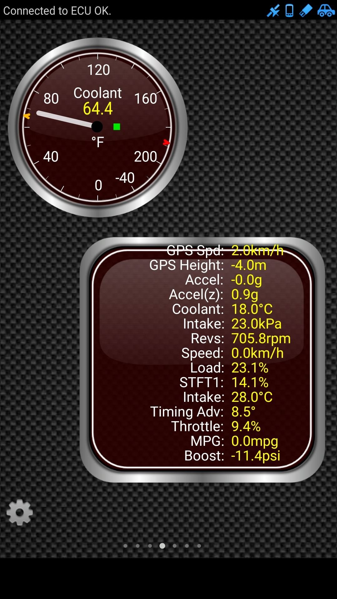

Remember when you wrote this: I have a obd2 monitor hooked up and the app on my phone. When the temp gauge drops, the temp showing on the app on my phone would also drop and pick back up when the gauge itself did also. If you need more info, please let me know.
I wanted very specific information here. I wanted the actual coolant temperature data from the PCM whenever the gauge drops.
Anyway, you've probably either got a bad temp sensor (for the computer) or poor connections. I'd probably screw in a new temp sensor.

I'll run the car and the app later today and let you know the temps. I remember when the temp gauge actually drops down to the bottom and bottoms out as if it was sitting all night, the app says it has no connection to the sensor. I was thinking of replacing either the ECT sensor or the fan switch but if either sensor was bad, shouldn't I get a CEL? should I replace the ECT sensor or the fan switch that is connected to the thermal housing?
Old Sep 30, 2018
Re: Overheating and temp gauge issue.
No connection to the sensor, or no connection to the entire engine computer (PCM)? (no live data received at all)
If it lost connection to the entire PCM, open the hood RIGHT NOW and put wrenches on the alternator mounting bolts make sure they are all tight. Tighten them before the PCM gets ruined completely.
I believe it just says the sensor lost signal/connection I have other graphs and whatnot to monitor other things and they continue to work as normal when the coolant sensor on the app and temp gauge itself drops and loses signal. I'm not home ATM but when I get a chance I'll warm the car up and grab some screenshots of what the app shows when the gauge drops.
Old Sep 30, 2018
You're reading this through the OBD2 connector like any other scanner would? Weird.
I expected just about any scanner to display a temperature value, even when the coolant temperature sensor is disconnected the live data on my scanners shows -40*
Not all faults set codes, and a fault code is not always a diagnosis.
It also helps to know the set criteria and time allowance for each individual fault, but that info is hard to come by.
You can have a sensor glitch or skew that drastically affects things, but as long as the value is plausible the PCM won't flag it as a fault.
This is a good example of why one should not rely solely on fault codes.
The radiator fan temperature switch is not monitored by the computer at all, it cannot set fault codes.
You can overheat the engine until it quits running on its own and it won't code until the coolant temp sensor is so hot the computer thinks it's a short circuit. (I believe that's around 300*F)
alright so I ran the car for a total of 30 minutes. Took 11 minutes to get to normal op temp - 179 180. After 5 minutes the temp gauge dropped to dead cold. The app did show a connection the whole time with the sensor but the temp shown 64.4 on the app - screenshot below, remained there for about 2 minutes and the app suddenly shown 195 and the temp gauge itself climbed back up to normal range. After 15 minutes or so from when the car first hit normal op temp, the fan finally kicked on, both rad hoses were hot to the touch as they should be.
the fan only remained on for no more then 10 seconds, idk if this is normal or not. After it turned off it took another 5 minutes or so and the fan kicked on again and stayed on again for no more than 10 seconds.
I let it run another 5 minutes and then shut it off, got called in by the girlfriend.
ECT sensor is bad. Replace it ASAP.
Then top up the radiator and burp it of air, and all that neat stuff.
Then drive it daily and watch for the common sign of head gasket leakage. .
Fan cycle and run time is normal. It only runs when needed, and only long enough to cool what's in the radiator a few degrees.
You could replace that temp switch if you want for peace of mind, but it will act the same as you described here.
