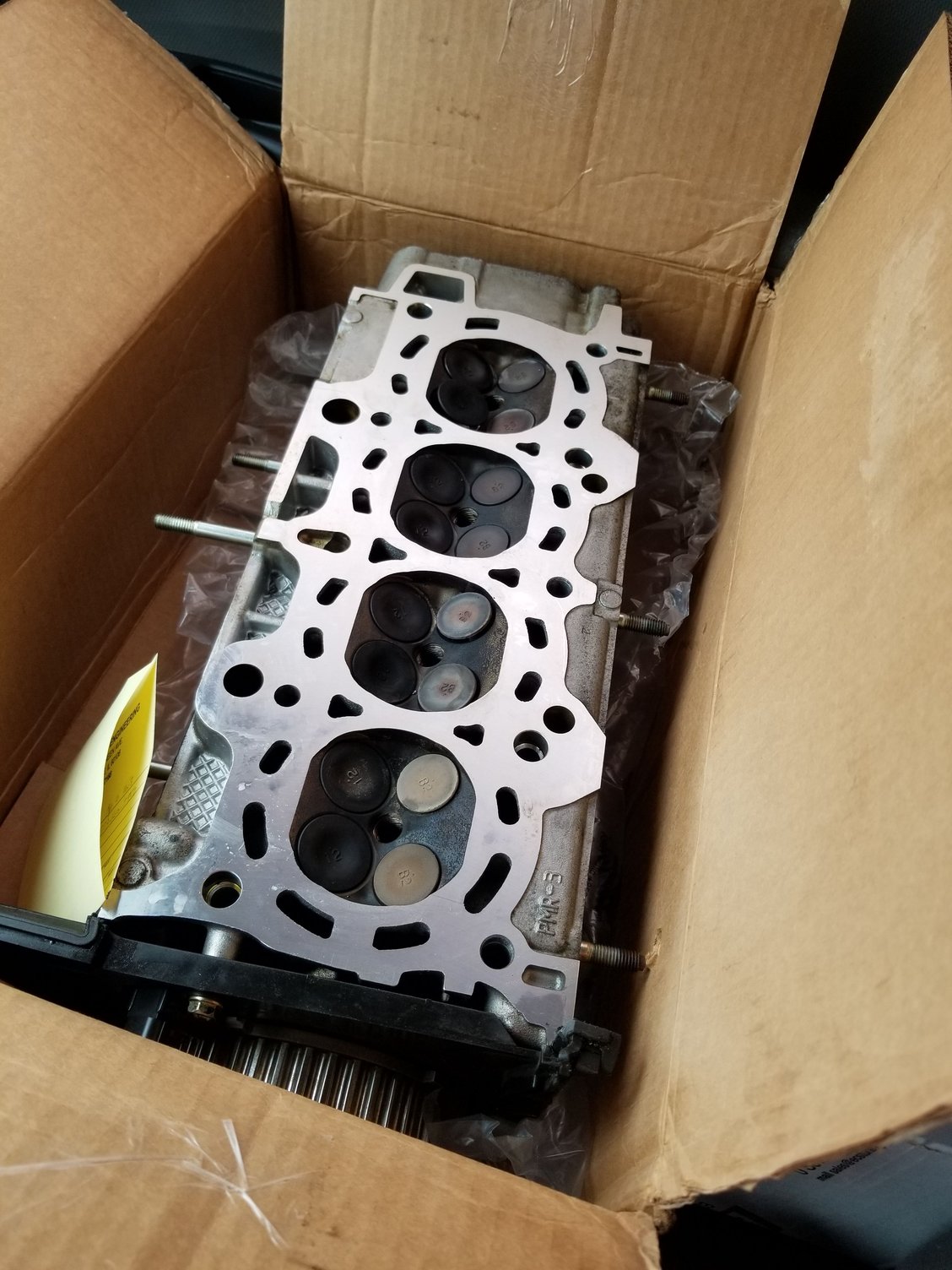

Head came from the machine shop. Cleaned and ready for install.
Wrapped up the install today.valve cover went on as well. Everything was at TDC, checked it about 6x before it got closed up. Just need to install intake, coolant and bleed and keep my fingers crossed it starts up
