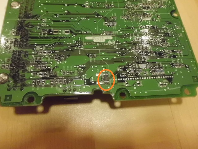

Open the ECU and inspect this resistor.
It is 20 Ohm SMD resistor.
Replace it if looks burned or just solder iron on top of it new one.
I had similar experience in the past
