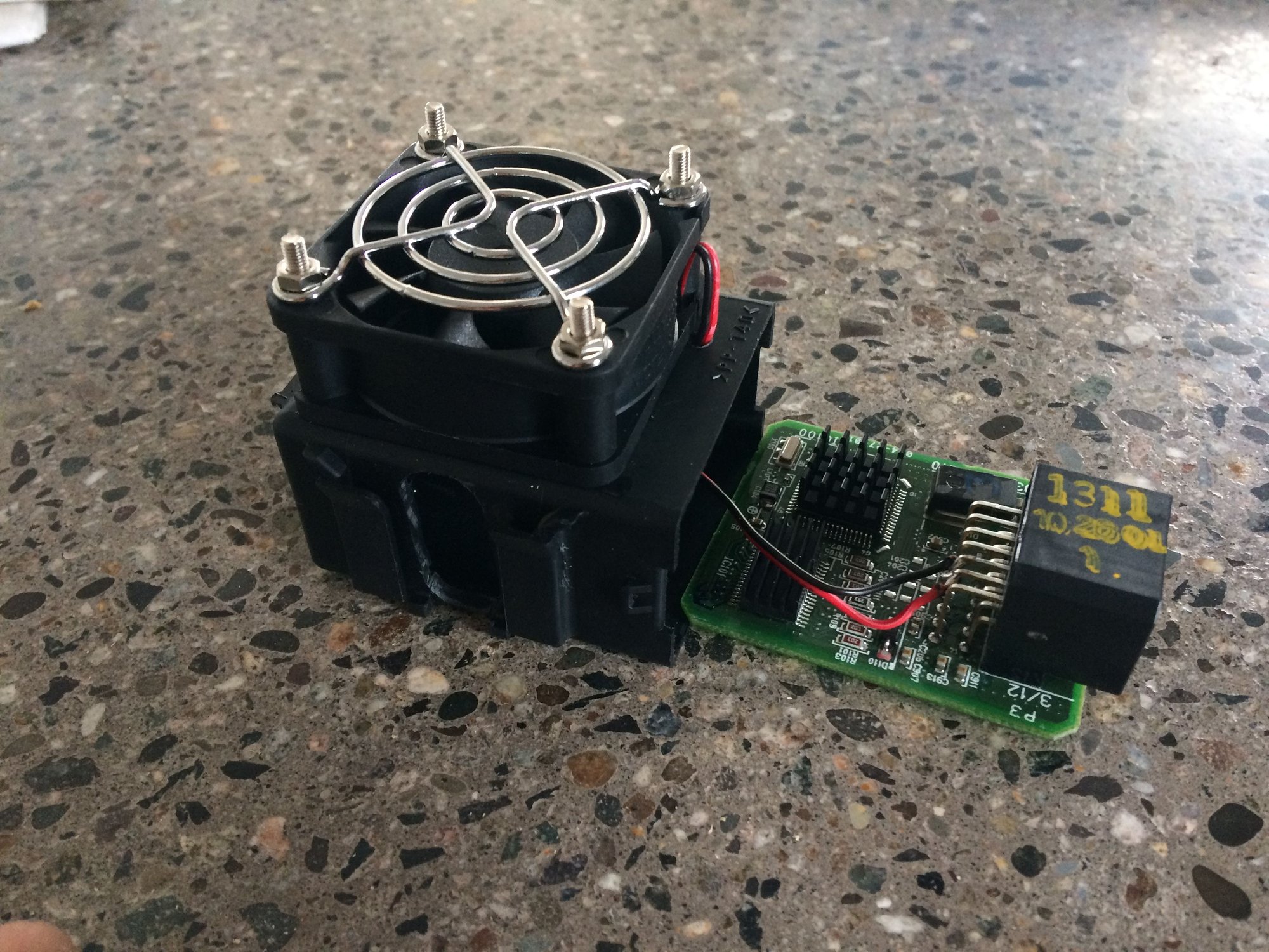

It might be a chip on your cruise control module overheating. The module is inside a black plastic case about the size of a cigarette case. it is mounted to the underside of the dash near your steering column. Remove the front bottom dash panel and look up for a box. It is mounted with one bolt. I think 8 or10mm. Remove the bolt then open up the black case holding the module. remove the circuit board from the case, this is your module. Next leave it connected and just hanging by your leg. Turn on your a/c and adjust your vent so a/c comes out dash and floor. Test drive your car with the cruise on. When and if your cruise kicks off by itself again then feel the module, in my case one of the chips, cpu's? was very warm. When it cooled off the cruise would work for a longer time than usual.
I fixed mine for less than $10.
1 I bought a 12v mini cooling computer fan - small 40mm x 10mm
2 I drilled a 1" hole in the black case that holds the module on the opposite side of the chip that was overheating
3 I drilled several 3/8" holes in the other side ofthe black case and also drilled holes in the edges
4 I mounted the fan on the case with 4 small screws i had in a junk drawer
5 I made the power wire 8" longer by splicing and ran that to a fuse that is off when the key is off and on when the key is on. I hooked the ground wire to the mounting bolt for the black case.
6 I put module back in case hooked up wires remounted black case and verified fan on when ignition on and off when ignition off.
This solved my problem. In the summer I keep my ac directed to center/floor position. I have driven 1 1/2 hours without my cruise kicking off. Hope this helps some others as I really missed not having cruise control.......well besides the 2 to 8 minutes I might get in the winter.

I had the exact same issue that OP had: cruise works for ~20 mins, stops briefly, tries to recover, and gives up. I checked all the ACC fuses and no good. This thread is the closest I could find to an answer, and here is what worked for me.
I replaced the Auto Cruise Controller (ACC) unit. The same one the guy mentions above with his homemade fix with the computer fan. I found one on eBay for $20 including shipping (new, they are still $250+). Popped it in in about 5 minutes and cruise worked perfectly. It's only been a day, but it hasn't quit on me yet.
