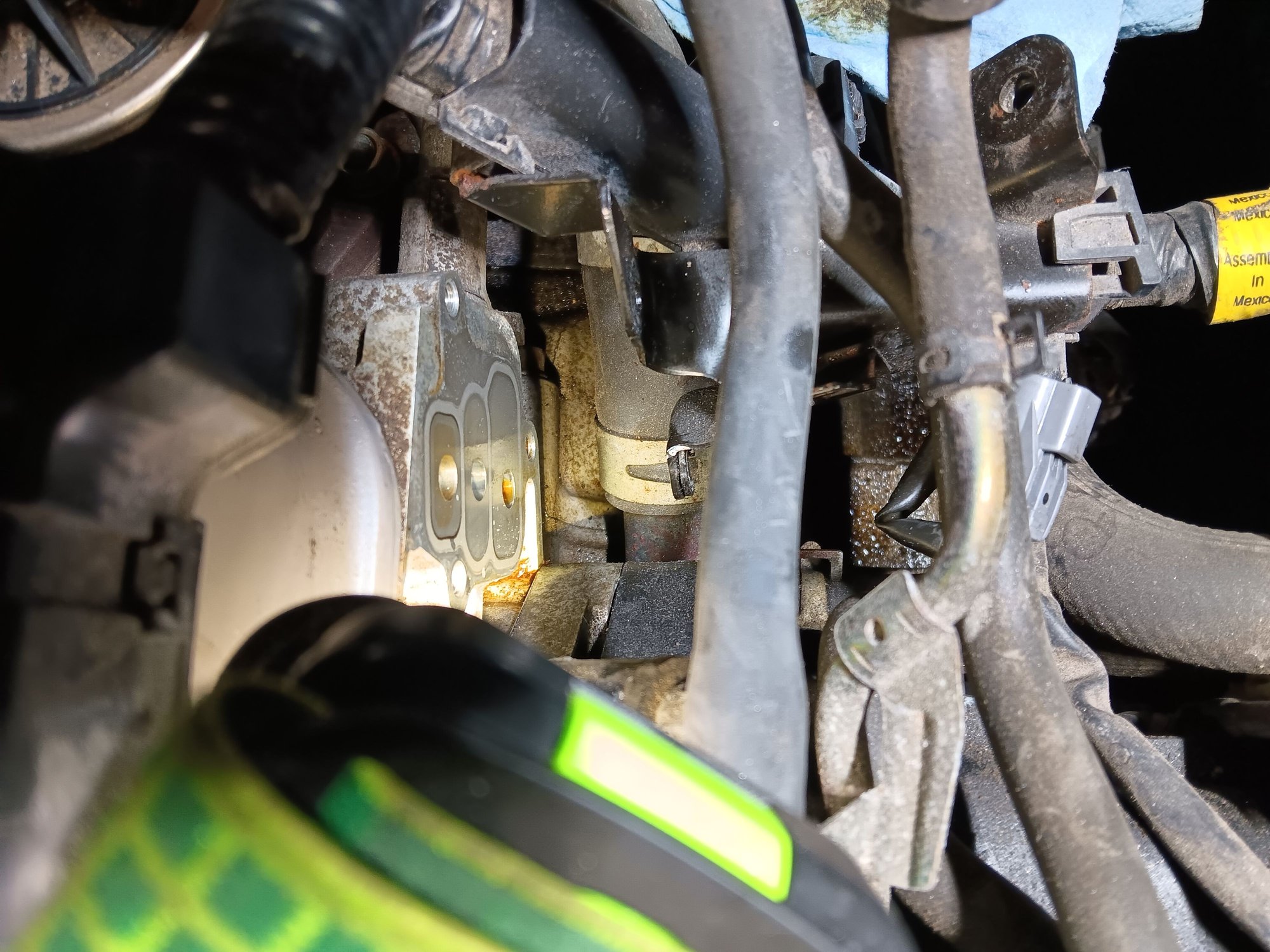

update:
I removed the resonator box and did some cleaning of the top of transmission, vtec solenoid area, egr, and valve cover gasket. before cleaning I noticed that the fresh looking oil is coming from under the "water passage?"(the part of the head that thermostat is bolted to). I'll get my scope working and look under there. I did not see any fresh oil from the upper areas. I'll drive it and update.

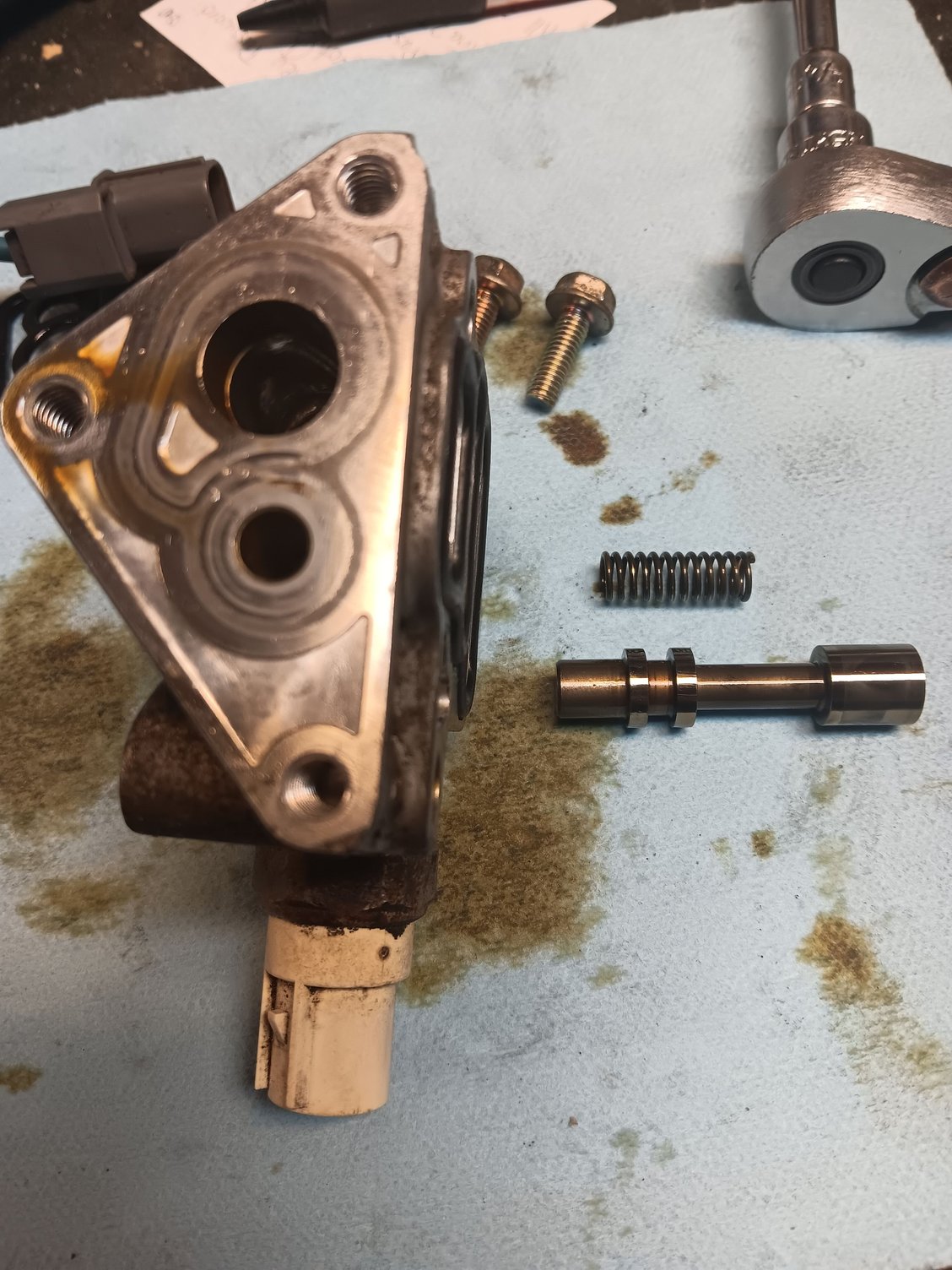

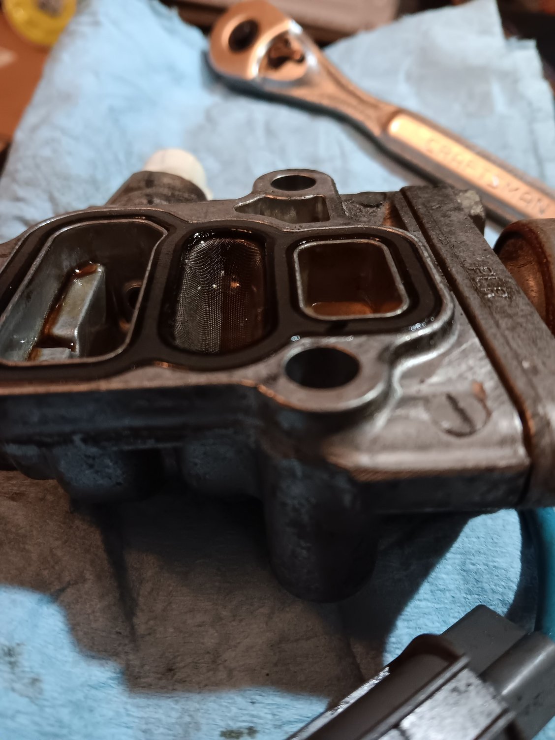

Update: solved
Found the leak. It was coming from the bottom of the vtec solenoid gasket making it not visible from above. There is a very good vtec solenoid fix YT video if posting a link is allowed on the forum?
Hope my pics look ok.
Very flattened gaskets

Mating surface, from above

Plunger valve and return spring
