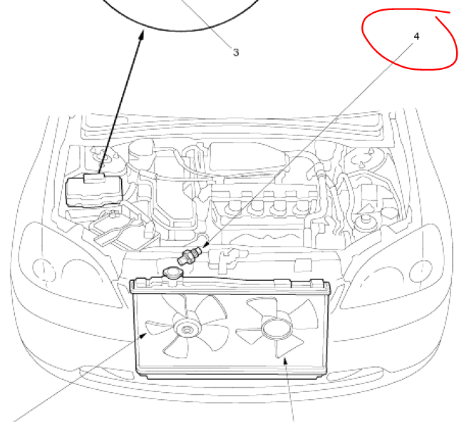

Hi all,
I have read over and over again almost a hundred forums and I just can't figure this problem out. I have checked and change everything people have mentioned. 2002 Honda Civic EX Coupe.
I changed thermostat twice, coolant fan switch off the radiator hose 3 times, ect sensor twice, new fan, known relays (even bought new ones and tested with other relay slots like horn), all fuses are good, bled the coolant multiple times for over hours. Idk what the problem is. The fans DO work when I hit the A/C on or jump with a paper clip at the coolant switch coming off the thermostat housing. Problem too is when I hit the A/C button and the fans turn on, it only stays on for about a minute. Is it maybe a wiring issue?? Ground issue?
Any help would be super appreciated!! Thanks in advance.

The radiator fan switch is located on the coolant neck, passenger side of the cylinder head. It should close to turn on the fans when coolant reaches 199F (93C). You've replaced this already?
If there is air in the coolant system (like from a leaking head gasket or from coolant being low) it can prevent the fan switch from working. If you really think this is a fan issue, jump the fan switch with a paperclip and leave it in. Fans will run continuously with ignition on. I bet it still overheats after a while.
Fans only running for ~1 minute with A/C on is likely a separate issue with your A/C. I assume it stops working after ~1 minute as well?
