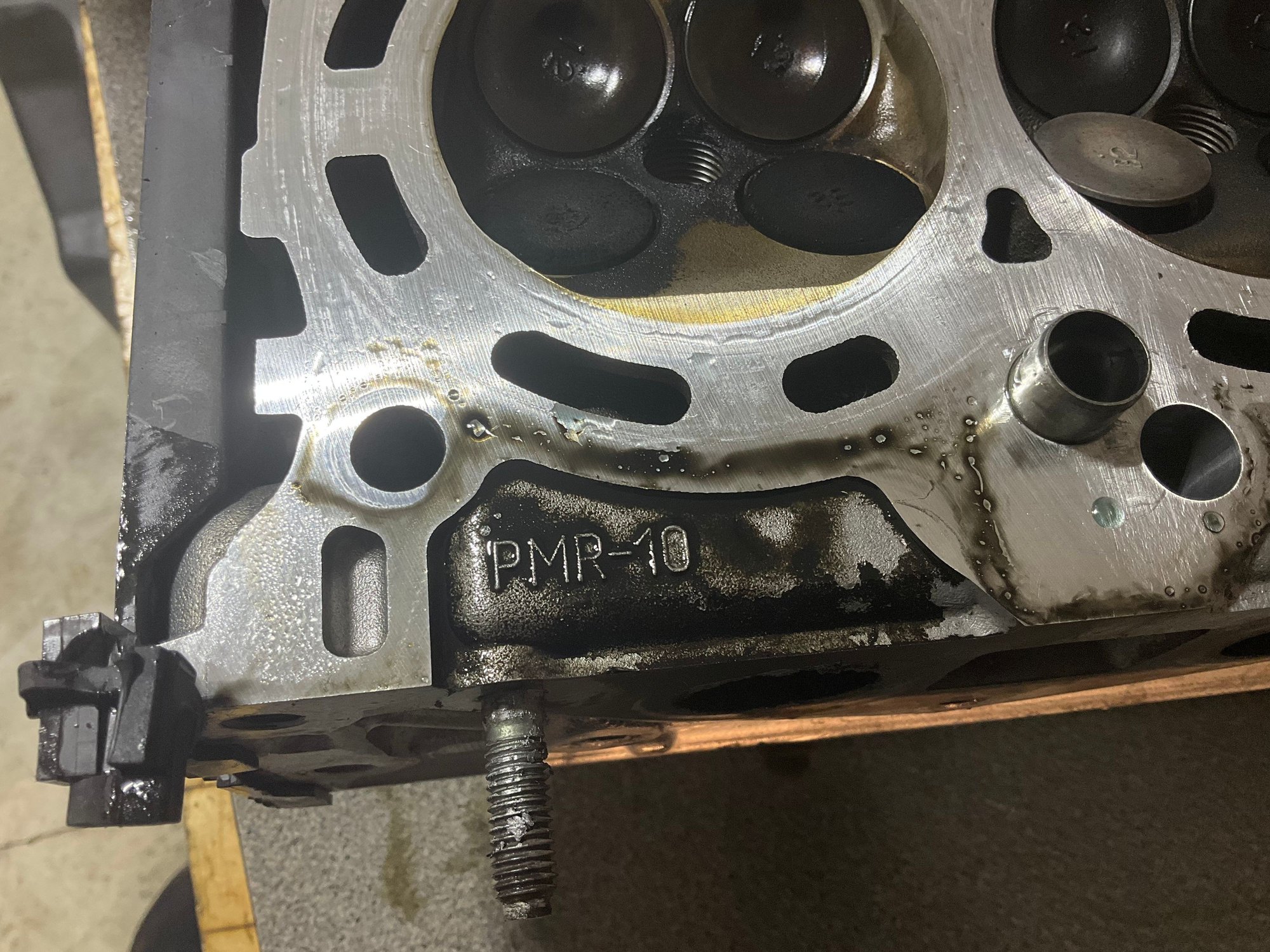

What do you think about this finish for my D17A2 cylinder head?
Is it acceptable?
Note: don’t run your fingernail across the screen!
I know it’s difficult judging from a photo but I can tell you the striations are just barely discernible with fingernail.

I would be more concerned about head warpage than surface finish.

^ This, but you shouldn't be able the feel anything with your nail
