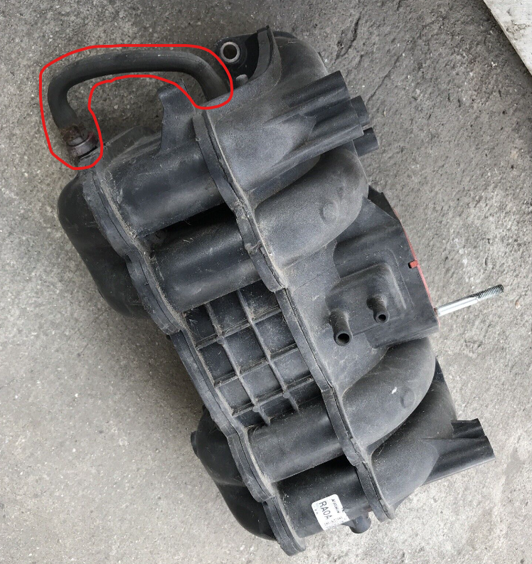

I haven't looked at a D17 in forever, but it kinda looks like it's supposed to be the PCV tube replaced with a generic ¼" tube. Previous own possibly had a catch can installed?
This pic of a D17A2 intake mani I found on ebay shows the tube I'm talking about
Check the side of your intake mani and see if you have a port that's plugged

Everything I find says there shouldn't even be a hose there. It looks like it goes into the intake manifold right above the connection for the PCV. I don't have any idea why it's there but it would likely cause a vacuum leak if removed.
