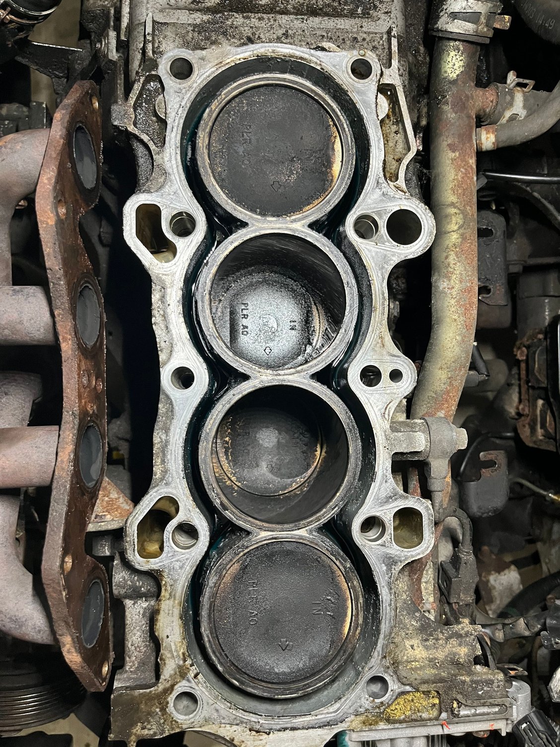

Ok. Look at my pistons. I can clearly see the markings. Valves are good. Doesn’t seem to be excessive carbon.
So do I do the rings?

Depends on a variety of factors.
If it's an otherwise healthy engine, I would leave it alone.
If there's any notable oil consumption, it may be worth replacing them. Even then, maybe not.

Depends on how we define healthy at 161k, but I haven’t had the car long enough to know wether it consumes oil or not. This is my conundrum. I sure don’t want the extra work, but I’ll be ding danged if I gotta crack this open again in the next 50k.

I probably would, then. You're already down there.

ALSO: there were no guide dowels when I took this head out. I will get two but any idea where they go?

They're not stuck to the head?

Not on the head nor the block. I’m wondering if the lack of them contributed somewhat to the gasket failure. Misalignment?

Definitely could be part of the problem

I did not replace the rings on this job. Check my other posts for how it worked out.
