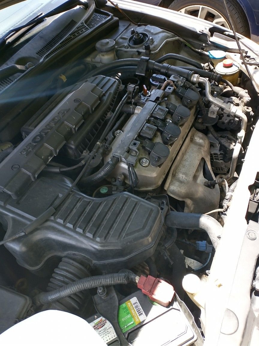

What i feared the most, The engine had been consuming oil from the last oil change of 5,000miles or so which never happened before and for a few days, it's been shaking randomly when i first start the engine but then all continue normally stable. Today started heating up and both fans in the front were working fine and the temperature will go to normal while moving at 30mph or so.
Now i check the radiator coolant and it was missing some of it, i put new coolant and it starts to bubble up constantly which seems to be consuming the coolant into the engine block. Dang, this car engine still sounds so good and smooth except for the little symptoms recently and i just ordered past week a new set of cv joint axles shafts and an oem low mileage Rack and Pinion. I had lived with this car since 0 miles for 16years, dang. It's my everything car and for delivery

check coolant reservoir. common issue

if it is headgasket, it is fixable.
I have other cars, so took my time to do, but can be done in 2 days first time, people used to it do in a day or less.
700 bucks in a shop?

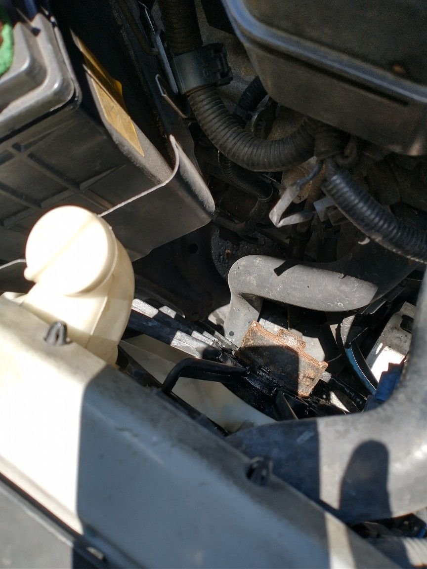

3rd photo down, the fan motor which I replaced 2 months or so ago, is all corroded. Must be the coolant leak or just water from rain?
That brownish wasn't there and I could be wrong but smell like coolant.

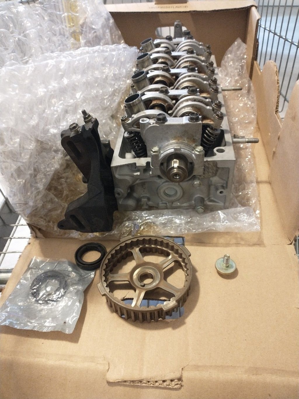

Out of the machine shop, they did the valves but I didn't trust it much and readjusted myself more precisely. Everything going good. Doing the drive axles and rack and pinion and steering pump replacements. Ordered the ngk laser iridium spark plugs. I may need the coils since they are over 200,000 miles.

I'm still waiting for parts to deliver to mount the head and everything should be ready. This has taken longer than I thought but too many other problems.
The valves seals part is still killing me thinking if they are good or how long they normally will last

I just had my cylinder head checked at a machine shop about two months ago. They did not replace the valve seals as they found no problems during testing. I haven't noticed any problems with oil burning.
However, my engine only had 154K miles at the time
awesome, good to know. The intake manifold to the head connection, the inside channels were completely dirty muddy all stuck in it. EGR gets a little dirty too and the intake.
