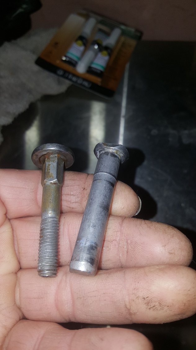

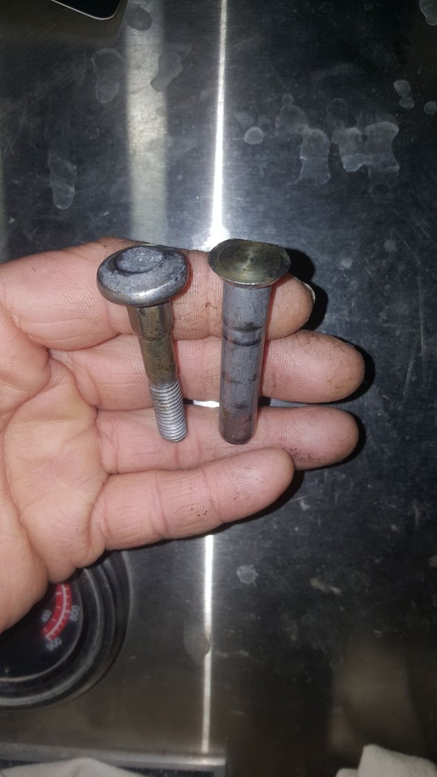

I hope everyone is good and anyone reading this is good as well. First off,
I apologize in advance for and if I am posting this new thread in an incorrect subcategory. I just finished rebuilding my 2002 EX D17A2 and cannot find where these 2 bolts go. I also do not recall removing them, yet I found them in the small pile of my final pieces to connect/install on the car. I thought I did a fairly decent job of separating and catagorizing everything as I was removing the engine and all its components. Any help is greatly appreciated.

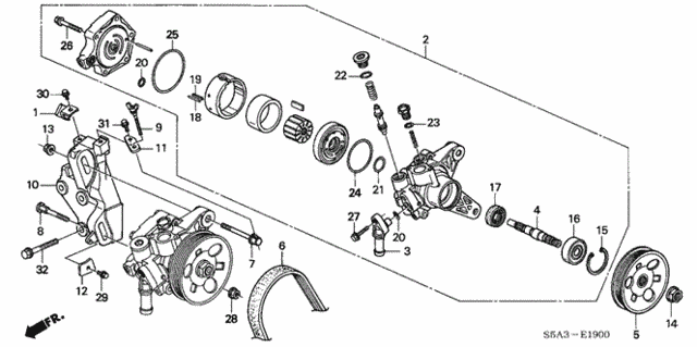

I believe the one on the left is the PS pump bolt that allows you to lock the tension in the belt. #8 on the drawing
I agree. I do not recognize the "bolt" on the right though. I don't remember anything like that being used on the D17.

Thank you riceboy and brotatochip! I will install the power steering bolt and I think I just remembered where the bolt on the right is from...(well not even bolt technically, more like a pin since it has no threads)...the shifter from under the boot.
