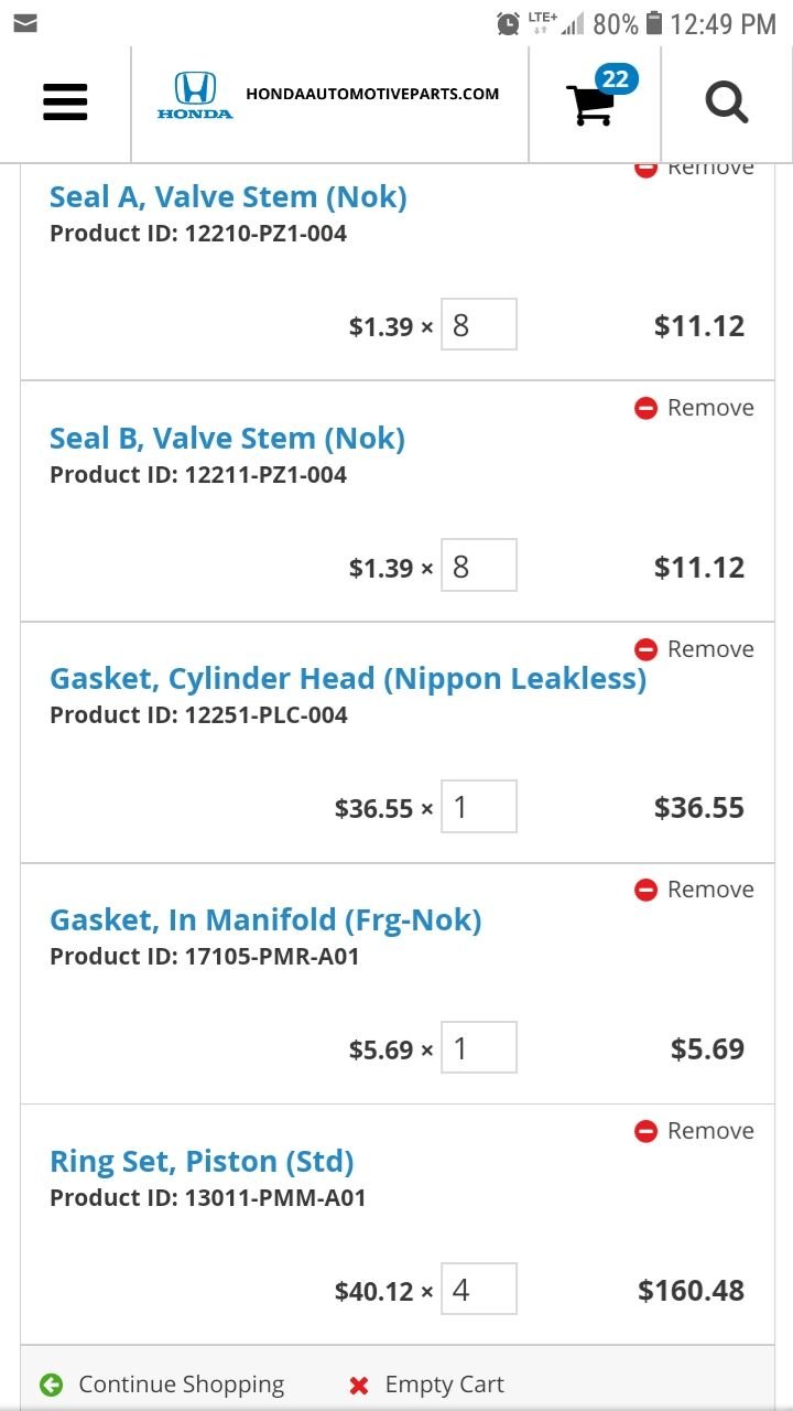

Hey ,I'm trying to order the parts but I'm seeing where it shows valve stem seal A and B.whats the difference? The intake valves are different from exhaust valves ?

And Also the piston rings, I should by the Standard size rings right?

So, the thing with the valve stem seals.. There are different part numbers for the intake and exhaust ones. However, when I got my head gasket kit in, all 16 valve stem seals were lumped into one bag. I couldn't see any discernible difference between any of them. I think it's safe to say the stem seals will work fine regardless if you put them on an intake or exhaust valve.

Ok..i am seeing 3 different sizes for the piston rings, should I buy the standard size for the piston rings.?

Unless your planning to bore out the piston sleeves and install oversized pistons then yes the standard rings will go on your standard pistons.
While you have that much of the engine apart, would be wise to replace the oil pump oring and both ends of the crankshaft oil seals.

Ok..here are my list of parts from majestic honda website.$ 224.00
